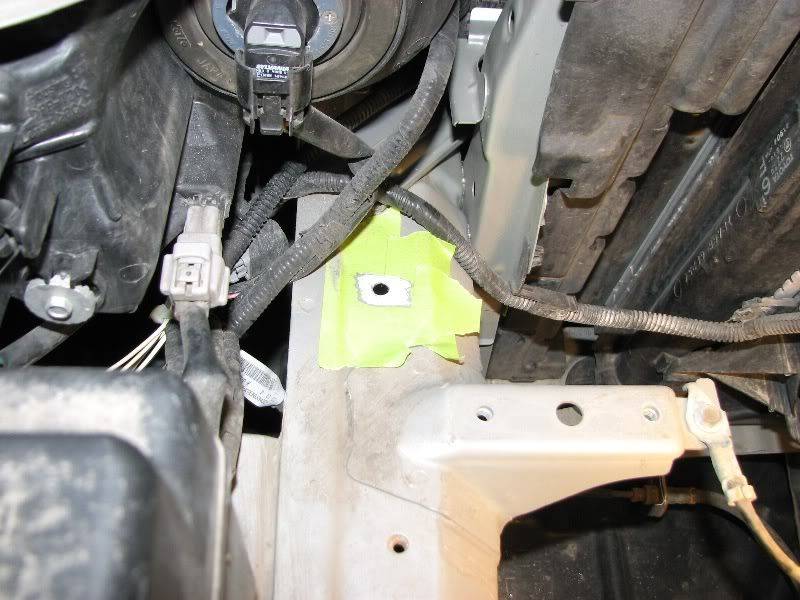

when you sand for a ground, mask the area off first, mask off just larger than the ring terminal. so you only remove paint where you are grounding. then seal the ground connection (on both sides) with dielectric grease or silicone.

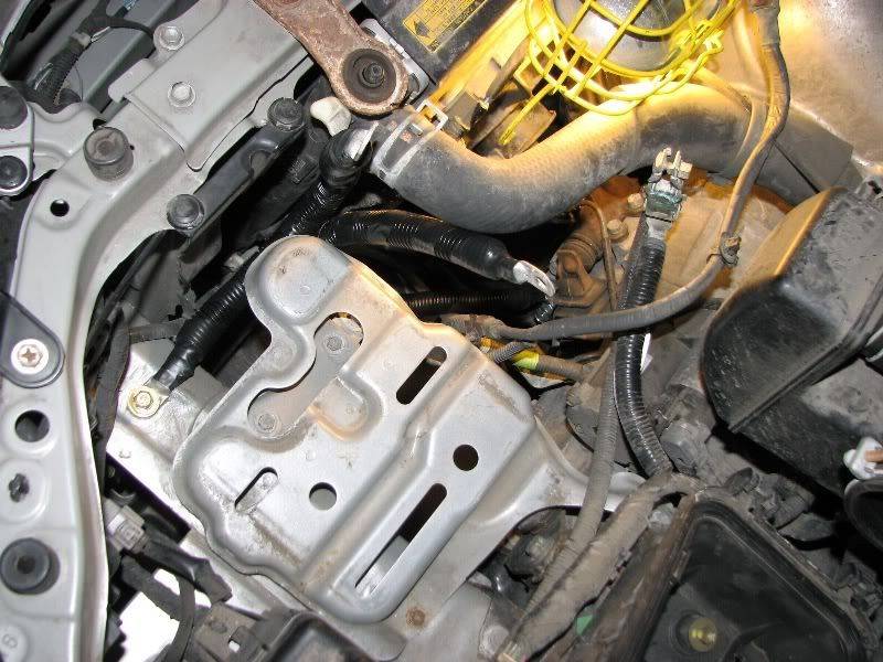

Engine Block to Frame

frame ground location

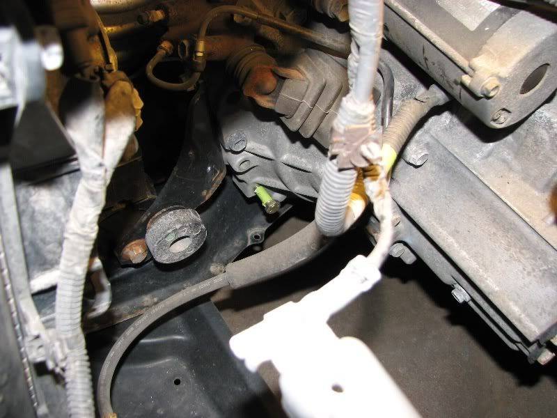

engine block ground location

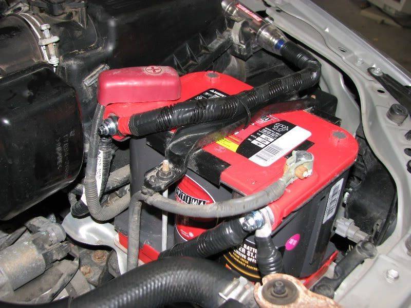

installed, grade 8 bolts used for grounds with silicone over the frame termination
terminated on battery
