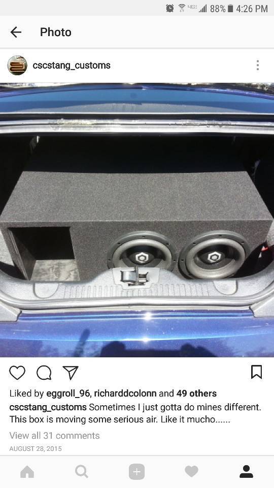

I'm looking at doing a box with 2 10's in the back of the new Mustang. Each sub will have ab out .88 air space. I'm looking for great subs that sound nice and clean not boomy.

None of the above, stop shopping local unless you got a hook up or it's a dealer only brand.
The box makes the bass. If the box is wrong a $4500 woofer will sound terrible.
If the box is right a $100 woofer will sound fantastic.
Which box do you already have? I prefer at least 1 cube for a sealed 10.

what amp are u running? look at dayton ho subs.. but the dcon is a real good option depends on power..
Can you post photos of your box? Rancho Cucamonga.
You're not far from here. Dual hds208 tline. Wow been running this for 2 years now...didn't realize that haha.
