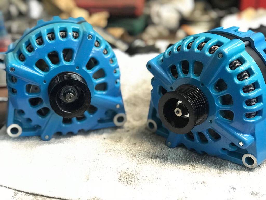

Did you swap belts to 1/2 inch shorter belt when you got new alt to compensate for smaller pulley ? Sounds like by the screeching that the belt was too loose and slipped until it wore thru ? I would put on a new belt tensioner too if you didnt already. By the way I just got a video of my new 300 amp hairpins doing close to 310 amps each and close to 200 amps at idle ! cant wait to get them on.

I still haven't clamped my alt but the video they sent me showed it peaked at 280+ and I have a 270 so thats good. They said 200 @ idle but I honestly don't know.
I need to clamp because I want to see what I'm putting at idle.
Tensioner keeps belt tight and the spring tension gets weaker with time, I put one on with every new belt and never have belt slip any more. Ya he sent me vids too but I couldn’t get them to load on the site but I can’t wait to see how 600 amps keeps my voltage up !

Are those from CES? They look really nice.
Yes they are from CES and should be here Wed //content.invisioncic.com/y282845/emoticons/smile.gif.1ebc41e1811405b213edfc4622c41e27.gif
