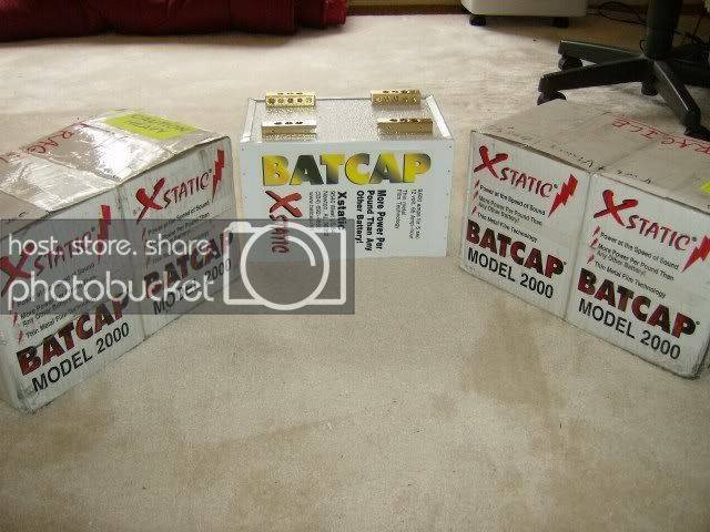

You have a pic of it ? I use to run the Batcap 8400s back in the day
Not really. I'm crunk. I wonder if he can do a custom distroblock. I just ordered 200$ worth of freaking battery terminals. **** I hate to return stiff. Need any? Lol
