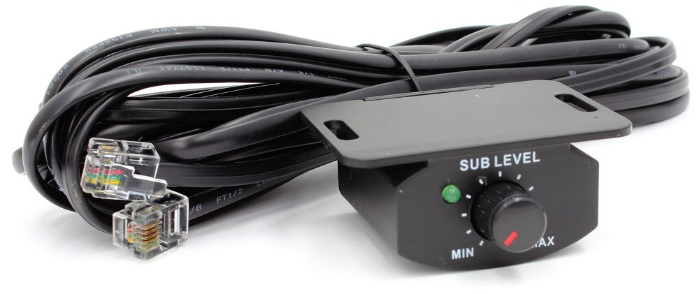

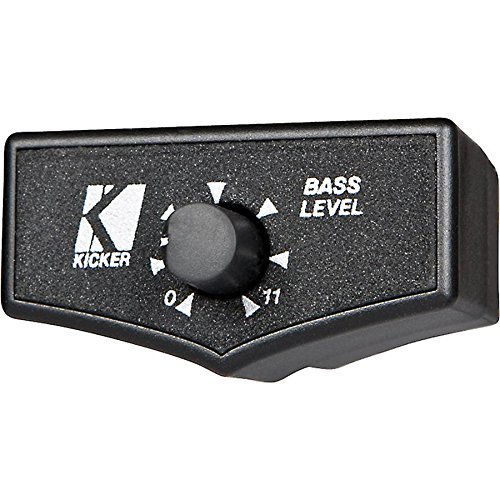

can I use any brand of remote control?
Example cheaper
Bass remotes have there uses IF you set them at max before you set the gain.
Uses are you can turn the bass down if needed to level out or you just want to.
If you compete you can use the knob to roll up the volume
