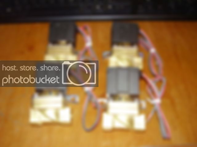

More goodies came in today...
Now I got to find a place to make me some l shape steel brackets about 1/4" thick. If any of you guys are capable of making let me know. Not sure whether to try and find 1/4" angel iron or just weld two pieces together. Which would probably be stronger?
3/8 smc valves
1/2valve with 1/2 line hops my buddies s10, and mine has got 3/8 valve and 1/2 line and i really like the speed. fast enough to lift up if there is something in the road but i can easily control my ride height without it taking off like a rocket. 3/8 valves and 3/8 line just seemed too slow for me, but its all preference. seems like its better to be too fast, because u can slow it down, as where if its too slow then your stuck with it. and as far as fittings. go here
http://www.suicidedoors.com great prices and the greatest customer service.
oh ya dont buy anything from AIM, chassistech, or any related people, you WILL get boned

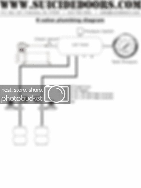

Alright so lets see if this seems about right...
(2) 3/8" forged cross
(4) 3/8" hex nipples (to connect each valve to each forged cross)
(4) 3/8" OD x 3/8" NPTF Male Connecter (to connect the airline from the cross to the bags and from the fill valves to the tank)
(4) 3/8" OD x 1/4" NPTF Male Connector (to go into tank plugs to air line and from bag plugs to air line)
And then just plug off the other slot of the forged cross till I get the guages installed.
If someone cared to doublecheck this that would be awesome.
No water trap? I would invest in one, if I was you.
Also, those first wheels would look amazing. BBS LM knockoffs, but nice nonetheless!
I would go with the strutbags from universal air, anyday. I love them.
Also, on a side note. If you're looking for a slower drop, consider mounting the valves further away from the actual bag. That allows a slightly longer timeframe for the air to purge.
I am going to run one, thats just a diagram on SD's site.
