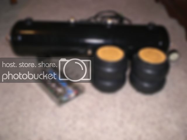

Getting stuff ordered for the rear...
Slam RE6 Bags
5 Gallon Tank

def second set of wheels. ive got a bagged s10. once u go bagged u wont ever go back to static. Slam bags FTW! what kind of valves and compressors do u plan on running? ill try to help you out all i can if u need it. the jetta uses a coil spring and not a coil over?
I ordered some smc 3/8 valves. Just four for now. I don't want it real quick, but I'm thinking about when I get around to the front getting ordering 4 1/2 valves and just using the 3/8 ones for dumps.
Yeah the rear is just a coil spring and the front is a strut, so not sure about them yet. Only struts I've seen for my car is from easystreet and I don't care for air lift bags. Guess they could be swapped out, but would be more money out the pocket.
As far as compressors I'm not sure what I should run. Maybe dual Viair 380s. I plan to stick with Viair as far as brand I guess though.
Yeah I have a vortex account, but don't go on there much. Seen some of the air ride setups posted there.
I don't know if you mean the bags I have chosen **** or if the choices I have for my car ****. This obivsouly isn't going to be a performance style air suspension. And for that case the Slam bags are very nice bags and awesome warranty.
i would do 3/8 valves with 1/2 line. its a nice daily driver speed, and u can always slow it down with "slowdowns" if need be. i would suggest doing dual 480s , the speed is good and 200psi ftw. i had a 450 and it only goes to 150psi, and then i got an air zenith, and its so nice having 200, and really nice fill times too

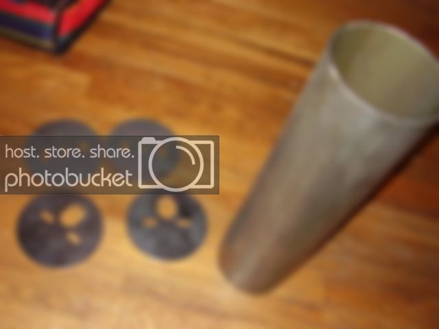

Pieces came to build my cups for the rear today...
If running 3/8 valves and 1/2 line what fittings would I need just to hook up 4 valves for the time being for the rear? Tank is 9 port 6 are 1/4 and the other 3/8 ports. I'm sure I can figure it out if I sit down and look at it though.
