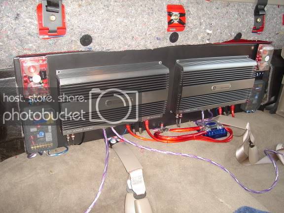

Alright, heres a picture of the back of te cab, with rear seat folded down. I want to mount the amps to this back wall where the grey insulation currently is, but will be carpeting the back wall after laying the sound dampening down on it.
-Lurius
Looks like a do-able project if you just mount some thin amps flat. Is that seat backing on a hinge? or did you just take it off and lay it on the cushion?
Its on a hinge. The seat, from the factory, only folds the bottom half up, to allow more back seat storage area(and no passengers), but I took the seat out and cut the brackets shorter so I can fold the upper half down to allow access to the amps(when I mount them anyways, lol) and to show them off if I ever want to.

That's how I mounted mine. I don't think you should pay a shop to do this.
What I did was cut .75" MDF into strips, sa about 7"x 1.5", and liquid nailed that to the valleys you are talking about on the back wall. Don't liquid nail the MDF to sound deadened area, won't hold (at least for me 1 strip didn't). Then I mounted my amp rack onto the MDF strips and mounted the amps.
** Note, I had an accident and the amp rack came down. I replaced one of the amps a couple months later and said phuck it and put 2 sheet metal screws through the amp rack into the cab. Thing ain't moving. Holds a fair amount of weight, crossovers(need to go active) and a DLS A3 and A6. You can do it! Good luck.

I found someone else on another forum that has a finished install like im talking about to give an idea..
The pics can be found in their album here:
http://chevytruckworld.tenmagazines.com/mygallery.ten-id-6141-album-13766
Theres some good pics there.
I basicaly am doing the same thing as they did, except ill be using those screw-in wire holders after I get everything else finished, just as a finishing touch, and to clean it up a bit.. I also plan on running the wires from the bottom if I can, I prefer it that way. The less visable wiring the better.
