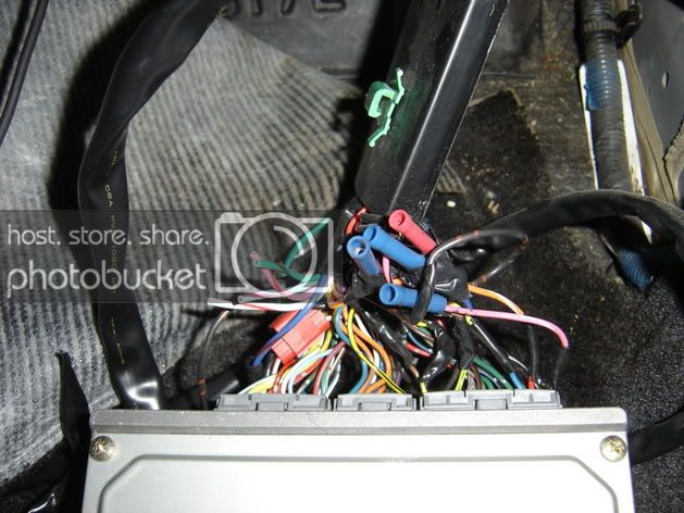

A ricer owned my car before I got to it. He tried to install a Greddy Emanage which is a piggyback fuel system that is able to help you tune if you're boosted. It's quite the shitty setup in itself though. I ripped everything out to repair for an Uberdata (Even though it's a "dead program," it will serve it's purpose for me for now).

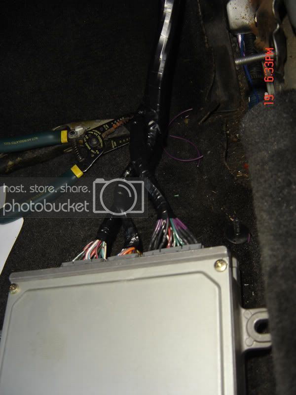

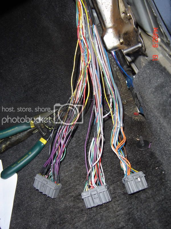

I didn't want to wait for the new terminals to get here. If you're careful with the old ones, you can pop the out of the block without damaging them; then use what wire you have left and just solder a new connection from end to end and pop them back in. This is another reason why I hate those butt-connectors is they wont fit in tight spots like this.
