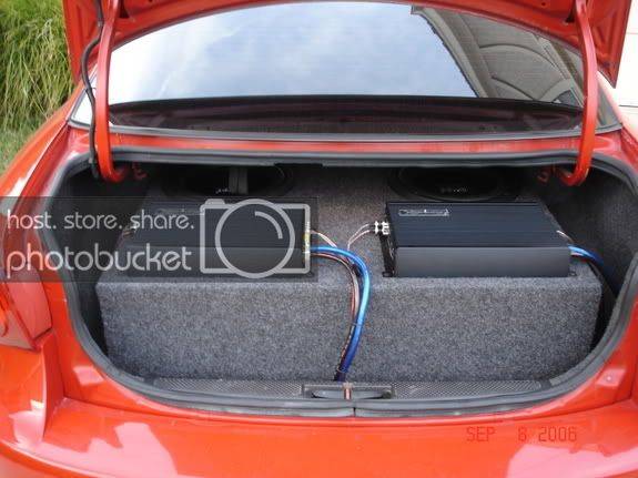

My sons box is bigger then the one you have and it fits in his 99 RS. I will measure it for sure and find out.. Did it fit easy hell no but with some muscle and twisting and shit I got it in.
Yea, I also thought about cutting the wings off the rear deck..... PROBLY NOT. but it was a 6cft with 120 sq in port tuned to 33, but too big, had to chop it down.
try taking the trunk lid and the arms that hold it up off to gain that room?
I thought about taking it off and maybe try to find different hinges for it. So if anyone knows where I can find some cheap reliable hinges for trunks let me know.
My sons box is bigger than the one you have and it fits in his 99 RS. I will measure it for sure and find out.. Did it fit easy hell no but with some muscle and twisting and shit I got it in.
I know what you mean, I ****ered up some of my interior trying to get this chit in there.

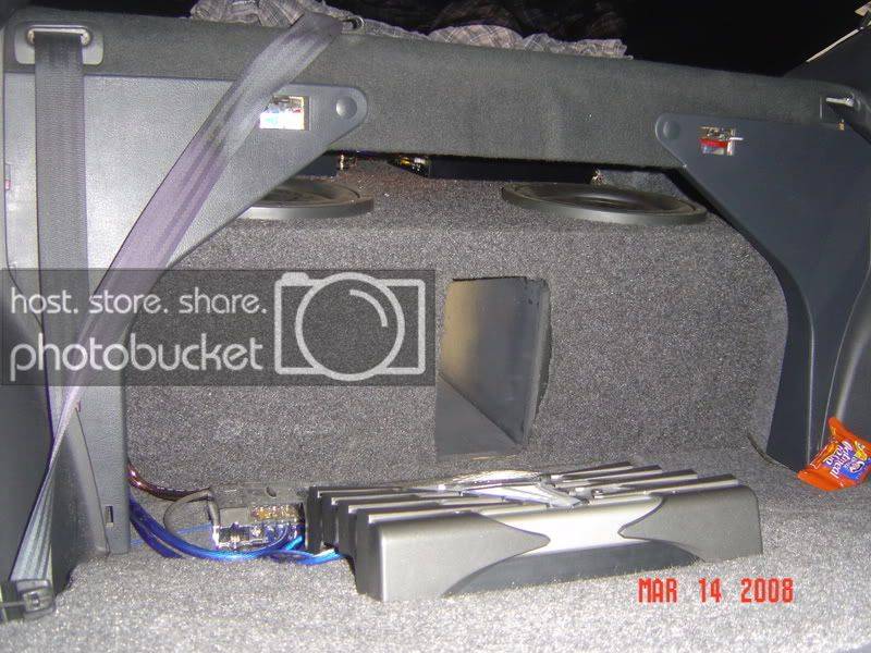

I posted these spec to show a single subs parameters. But I will be using two subs. How does subs up port back sound? Or subs up port passenger?
this box was once in my cavalier and was 6 cubes i believe after displacement. we had to slide box through rear seat area and had to cut car a bit to get it in there //content.invisioncic.com/y282845/emoticons/wink.gif.608e3ea05f1a9f98611af0861652f8fb.gif
how loud did this get? Whats the box tuned to? and do you know what the vehical Freq is?
