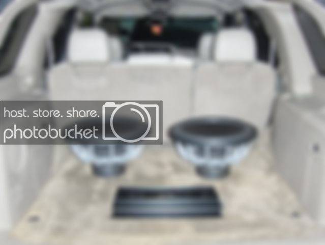

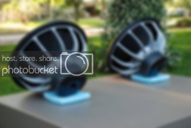

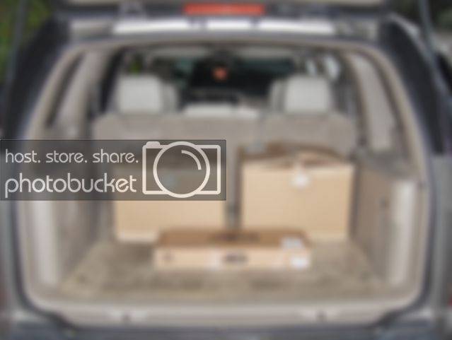

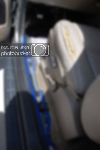

Finally got a client to rep some Ascendant Audio gear around town.It's a 2003 Chevy Tahoe total system overhaul.Should make for an extremely solid setup that is going to wail on the lows and have a lot of nice SQL.Build is a little over halfway through so I will be updating as I go.But here we are so far.

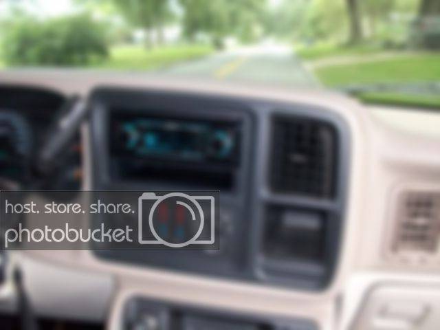

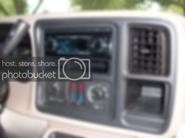

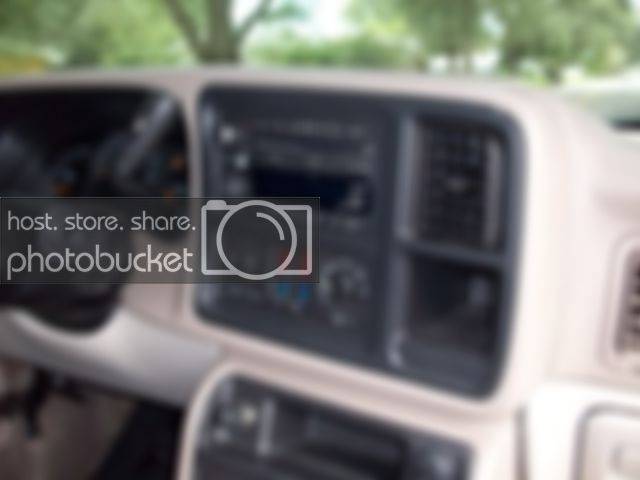

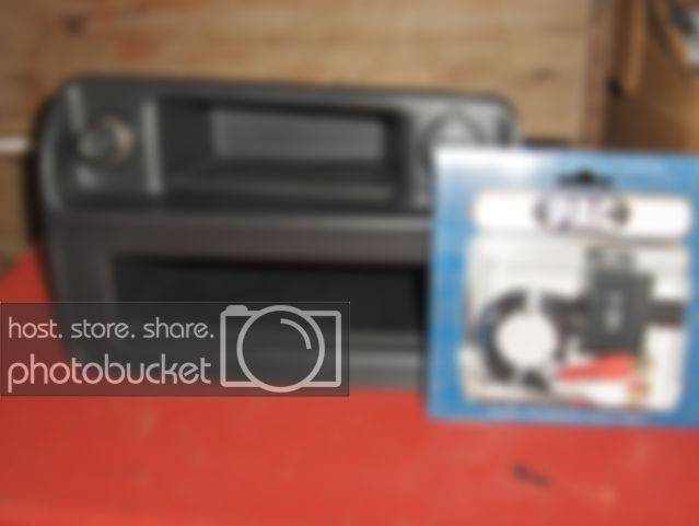

Kenwood Excelon KDC-X693

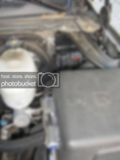

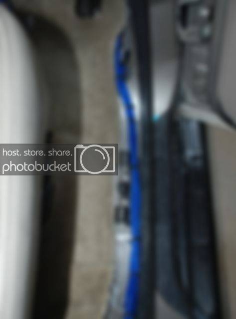

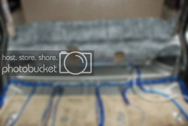

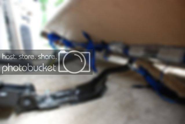

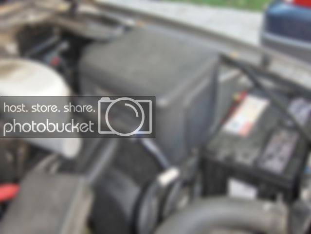

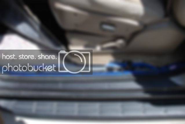

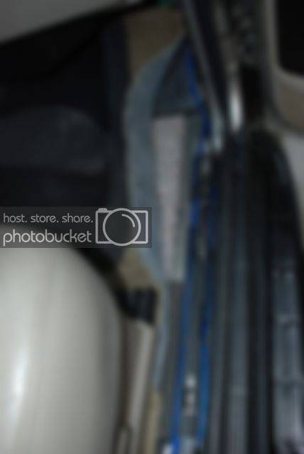

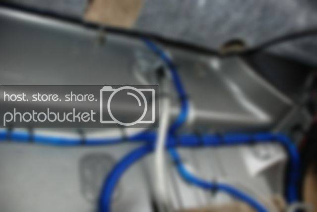

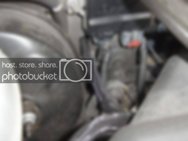

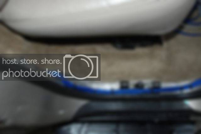

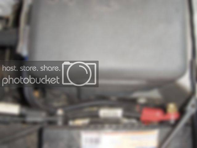

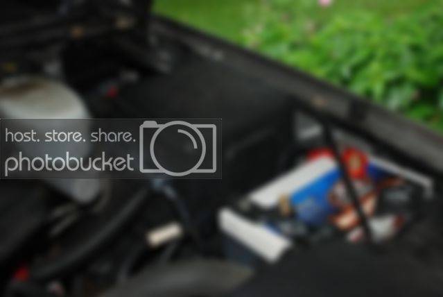

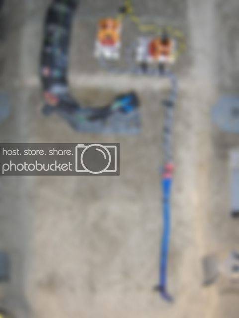

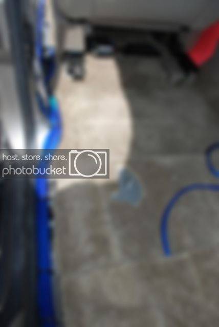

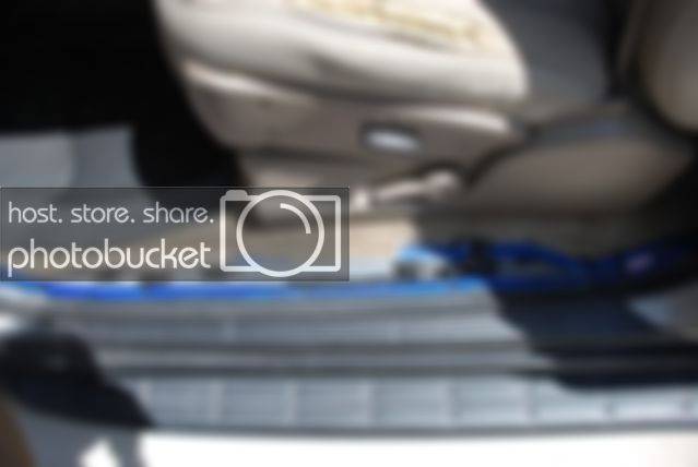

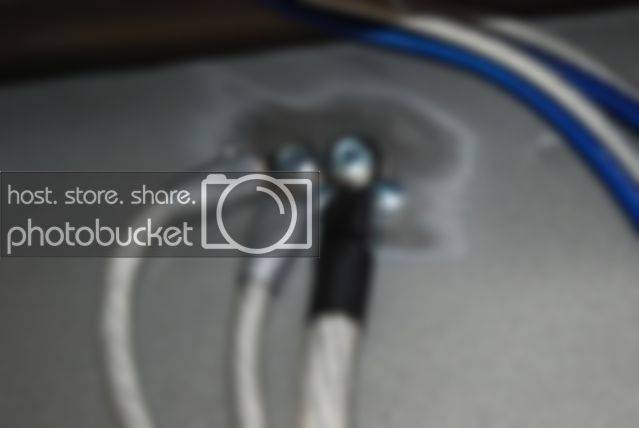

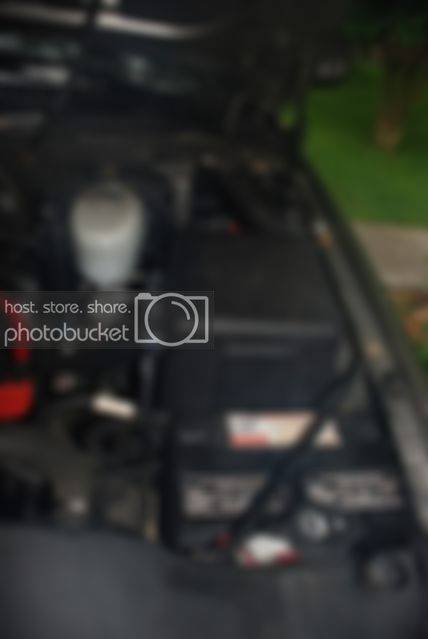

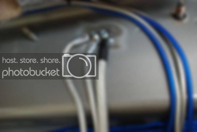

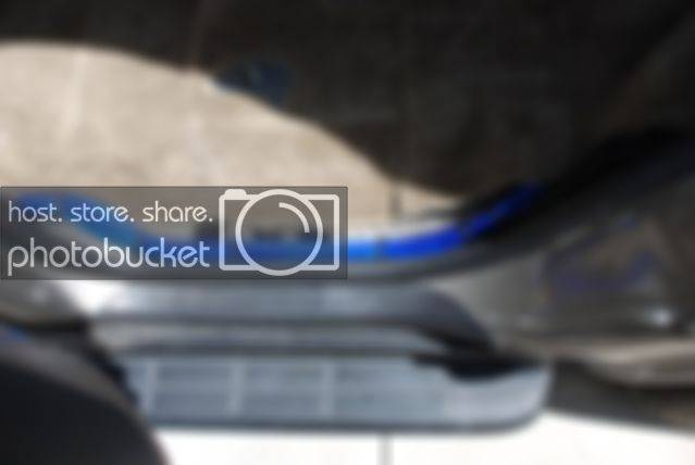

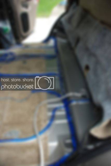

Stinger HPM 1/0 all the way to the back.

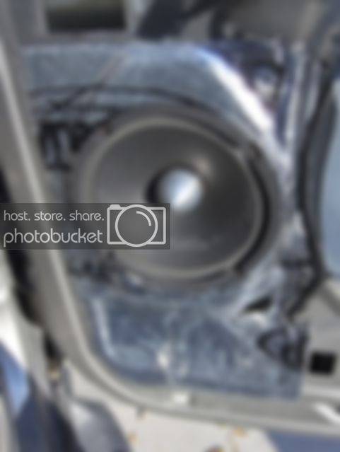

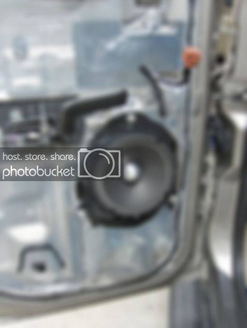

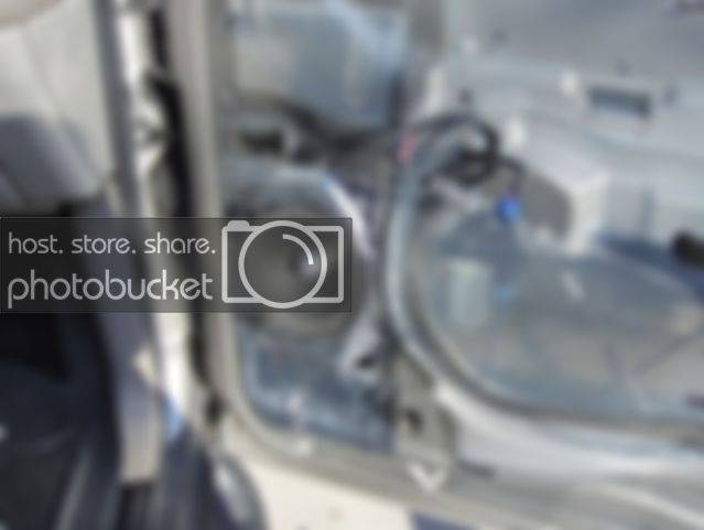

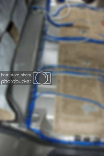

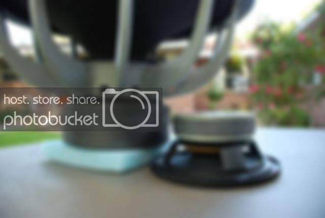

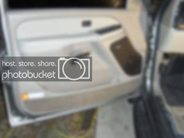

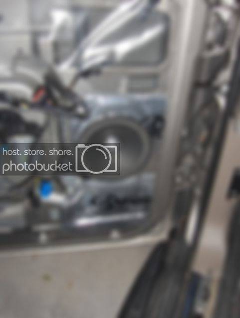

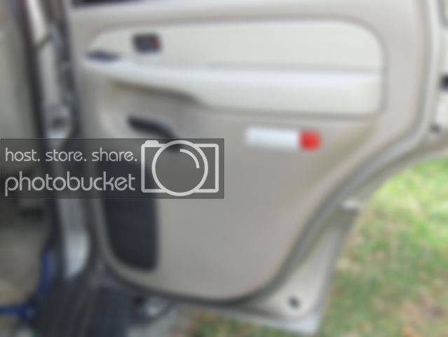

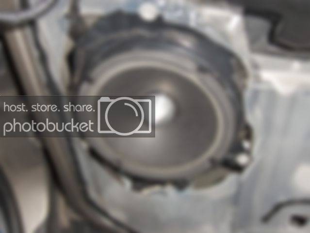

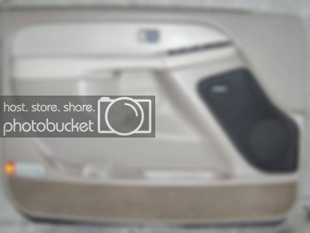

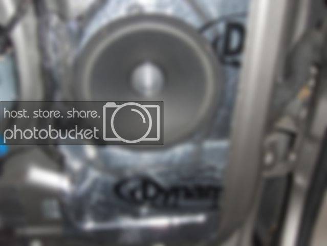

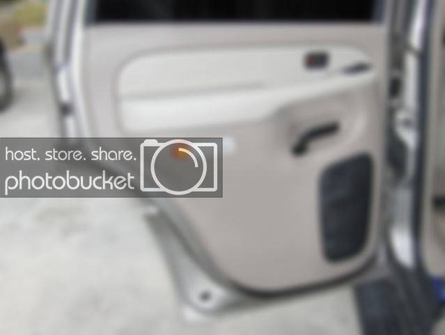

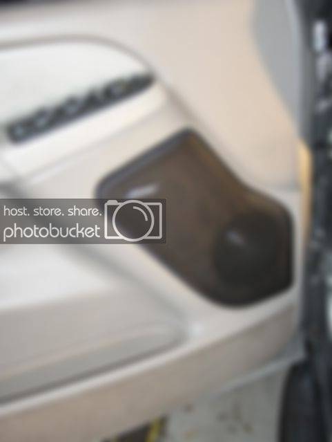

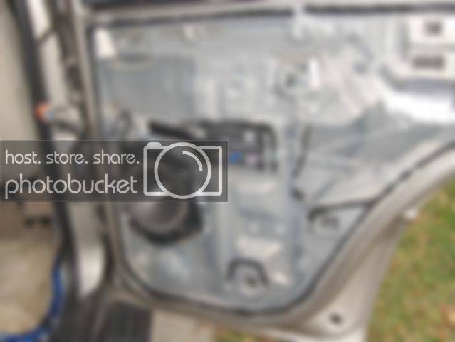

In the doors are Whip Audio 6.5s.They are incredibly loud and clear for an incredible price.Dynamatted the front doors around the speaker and inside the door behind the speaker.
I also went ahead and sprayed the grilles Satin Black while I had the doors off to throw a little more black in the mix and it turned out pretty nice for being so simple.

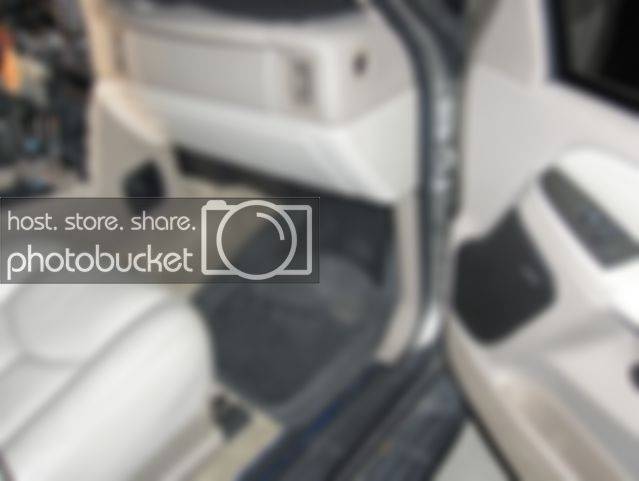

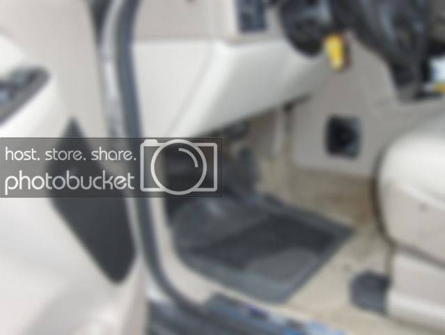

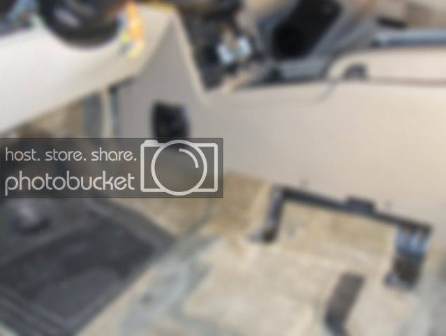

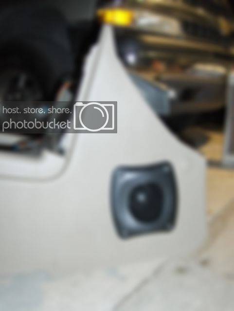

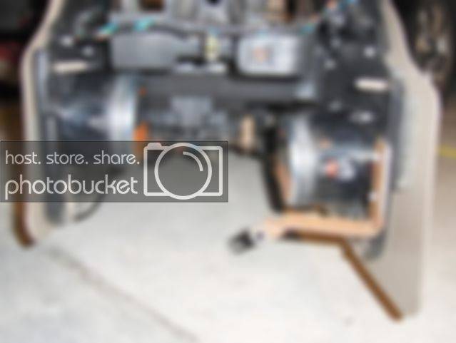

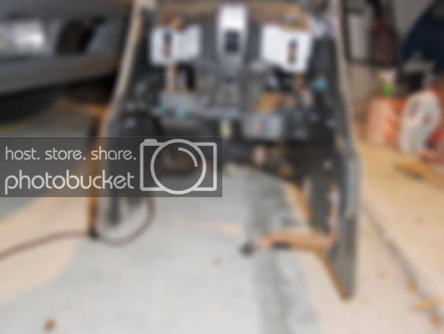

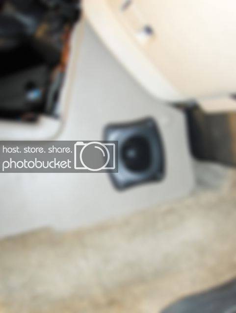

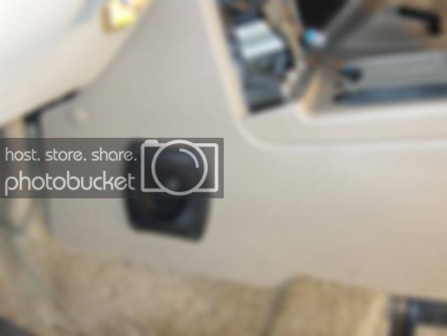

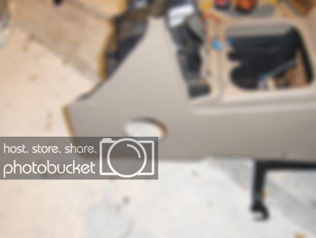

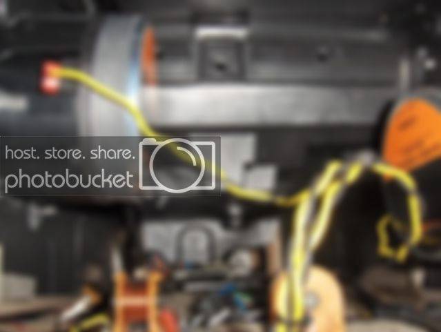

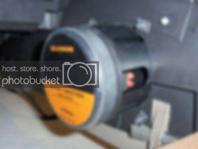

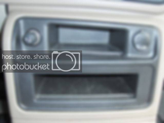

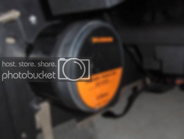

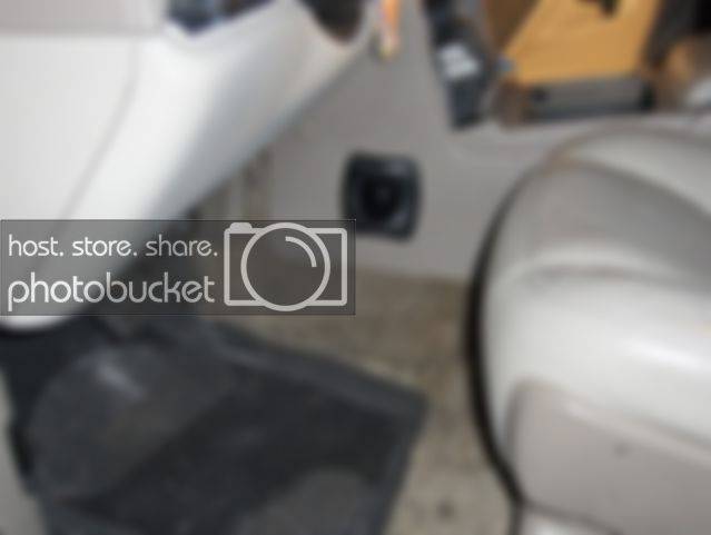

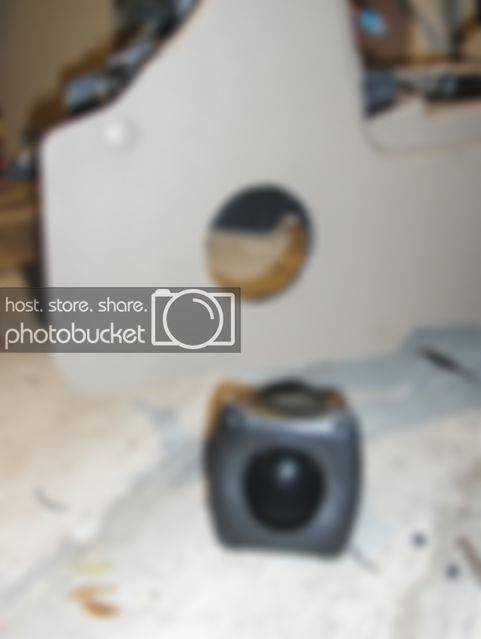

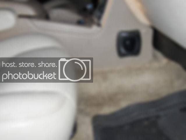

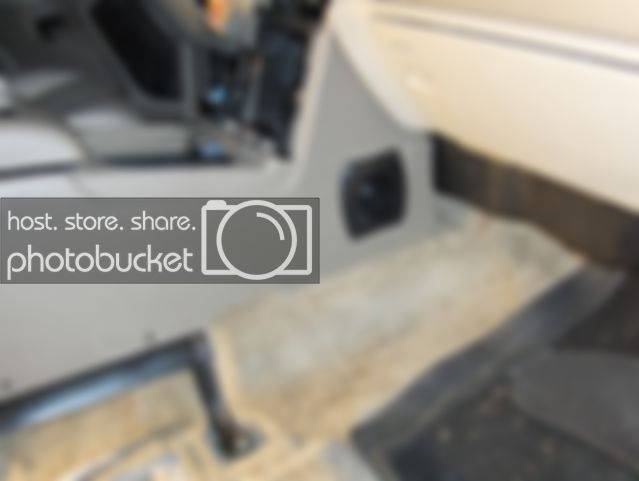

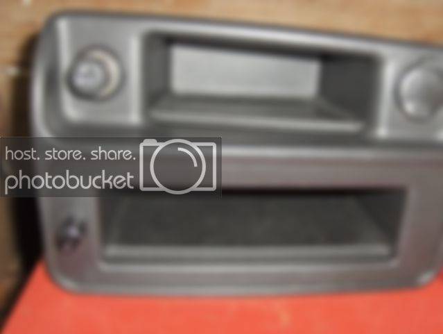

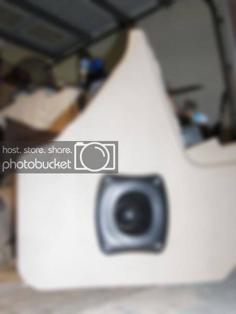

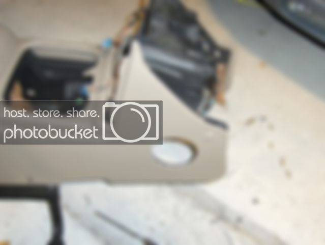

I put some Selenium ST350s in the console.They are crossed over with Selenium external crossovers at 4500 Hz.Had to pull the factory Bose system sub and box out of the console to make the 350s fit.To do that you have to strip the ENTIRE console down to just the skeleton.Like this:
