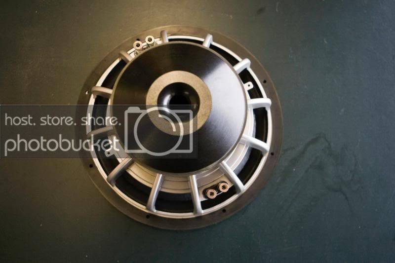

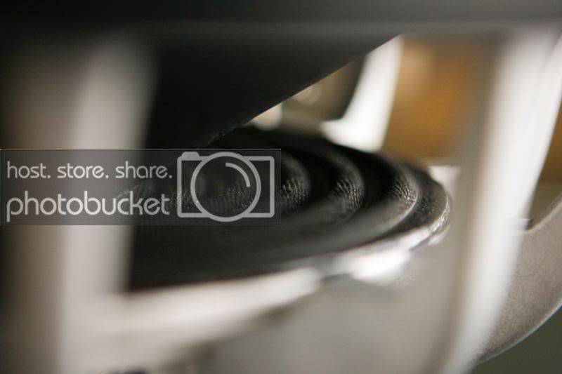

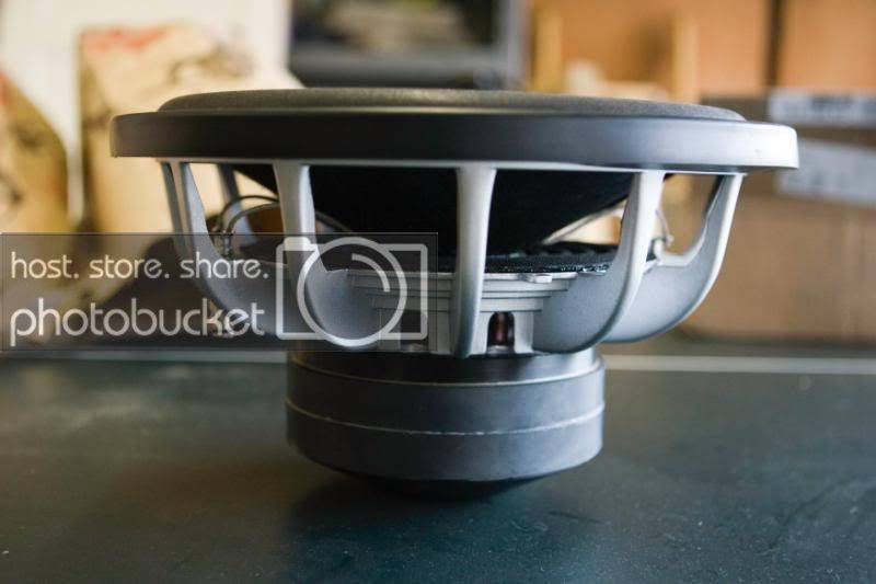

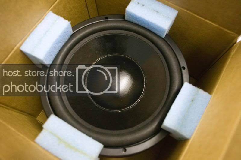

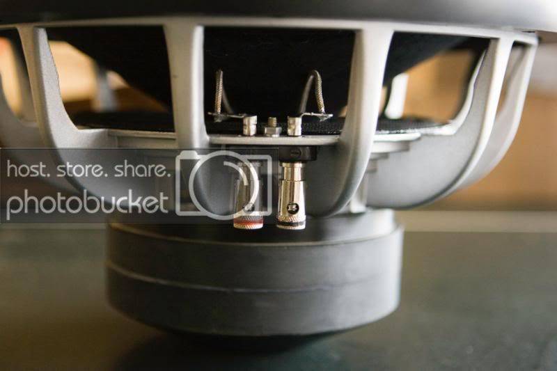

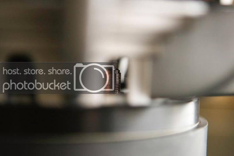

Top and bottom plates are black even though its hard to make out in the pictures because of the sub par lighting.
RMS is 500 watts. Just got it last week so will get to testing it next week. I'm super busy this week!!!
Thoughts, ideas, concerns?
care to list full parameters after break in? how big is the coil? what spiders did you use? what is the surround material made out of? foam i can see but is it santoprene surround?
I will list full T/S before and after its broken in. Coil is 2.5 Inch. There are 2 semi stiff spiders.
stop acting like you know wtf your talking about lol
Any T/S?
What kinda spider setup?
Size of the slugs?
Steel top and bottom plate?
edit* diddnt c above post
So im assuming this is an entry level sub w a 2.5in coil?
