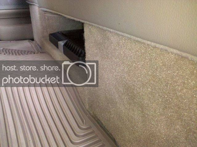

Heres the only picture ive found of underseat w6s and it only shows the box. But this is ALOT like what i want to do
Since I barely ever have anyone ride back their I'm not too worried about the seat lift. Just dont wanna remove the seat all together for looks reasons.
