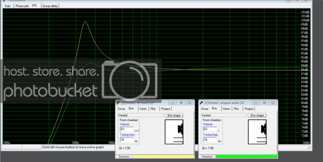

So i kinda leveled it down to 2 12" DC AUDIO LEVEL 3 or Ampere audio 3.0 as they require small boxes but i have found much on it.
I can fit 3.2 cubes total after displacement and i used win isd and i dont know if im doing this right but it shows that the dc level will kill the ampere with the same box and everything i have the same but i needed someone to check it out!
I am going to be running them off of a American Bass VFL 175.1 Thanks in advance
sorry its hard to see they are both in a 3 cube ft box tuned to 34 hz. Yellow is the dc and Green is the ampere audio. Maybe i have something wrong. But i didnt put 3400 rms for power i kept them both at 1 watt.

Here's tfade with a aa3.0v1 in 2 cubes. Looks beasty

That 10 dB knee in the response doesn't necessarily guarantee a one-note-wonder kind of bass, but that's much more narrow than I like to see for daily listening. See if you can get a compromise between the two graphs.

I asked him on caco and he said 2 cubes but bigger is better. idk if he's thinking of the v1 or v2 though. We want answers! If it's gotta be more than 2 cubes I'm just gonna go with a 10. Btw I'm color blind so I can't differentiate between the yellow and the green. Which one is the peaky data plot?
I dont want something that is a 1 note wonder. I want something that plays 30hz up to 55 well. Not lookingto compete i want a loud daily
Real peaky is the dc sub
