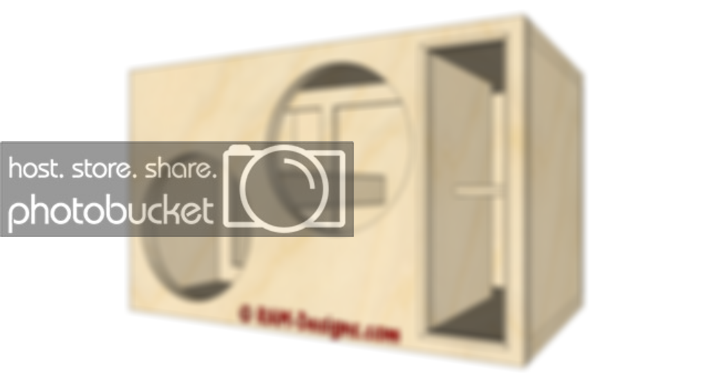

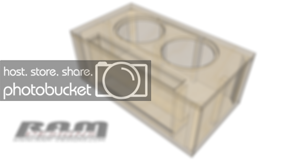

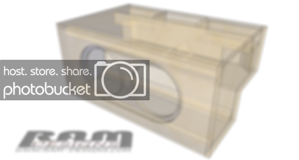

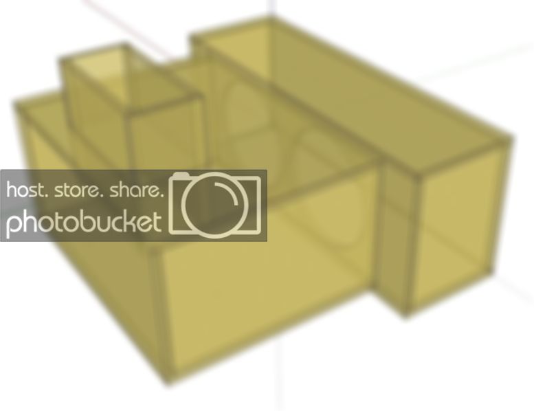

Nah, subs will be facing the ported chamber, will mount from inside sealed chamber.
Ah, I see. I was just checking since it looks like there's not any room for the mounting flange to be inside the ported chamber. You should double layer that back piece and add some plexi or something.
You're right, there's just enough room to cut 14" mounting hole then mount from the back. It will actually be two seperate boxes. That way I can put the ported portion in first and attatch the port. The put the sealed portion in and attatch the two boxes together, so it will actually have double baffle //content.invisioncic.com/y282845/emoticons/wink.gif.608e3ea05f1a9f98611af0861652f8fb.gif
