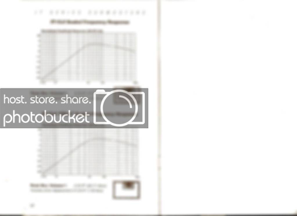

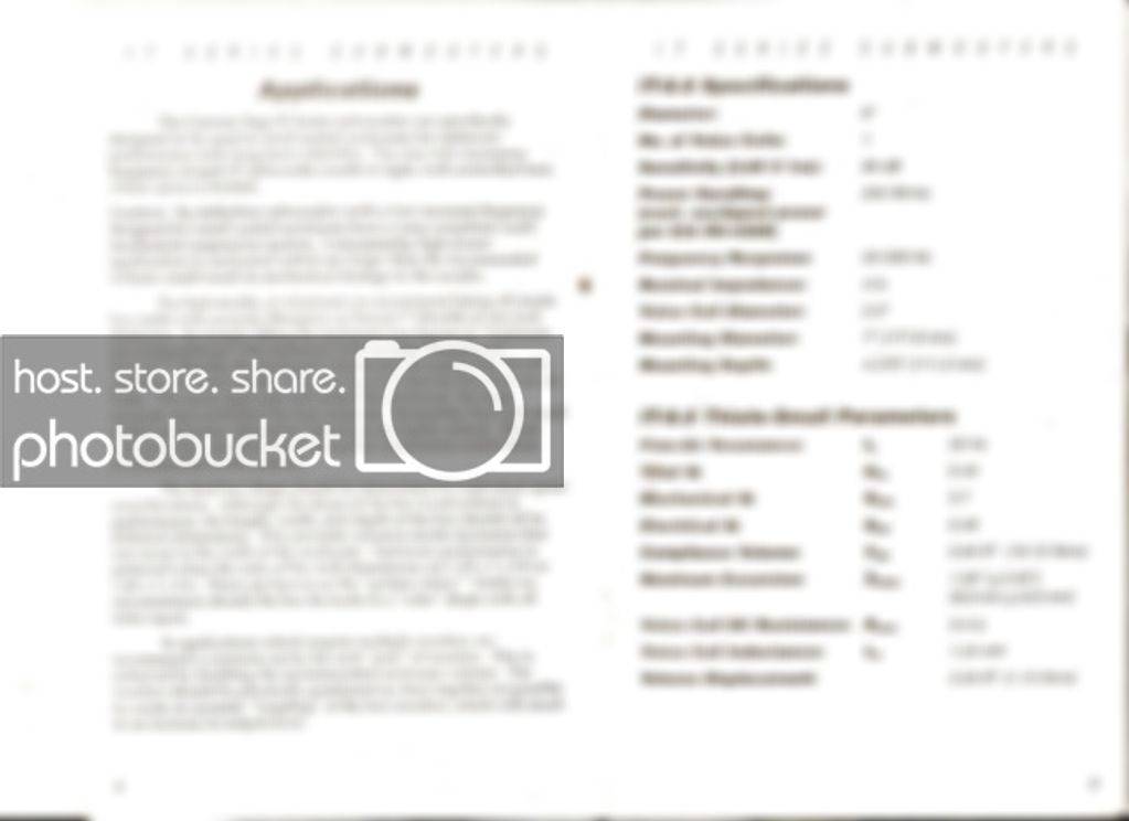

i used to have one. i loved the way it sounded in about 112liters tuned to 35hz. but do not use more than 600w on it. i ran 800w on mine and burned the coil. the it line was made for medium sized sealed enclosures or a bit bigger ported enclosures. the accurate image series was cerwin vega`s sq line at the same time as the stroker. and was made for both small sealed and ported enclosures. here is the manual for the entire it series of subwoofers
96db/1w/1m means it's very effecient and will absolutely NOT drop low in a sealed box especially a small one lol. Medium to large ported low if you want lows...
