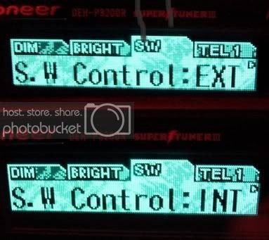

SET YOUR PRE-OUTS TO FULL. IF ITS A OLDER UNIT SET IT TO EXTERNAL !!!

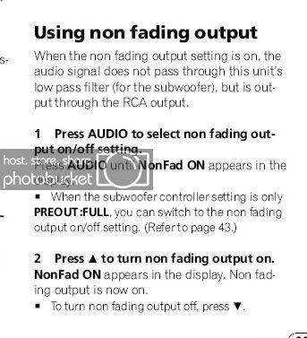

it even tells you in the manual how to set it. guess noobs cant read either...
Your pioneer model your using may have this feature but the ones we are talking about does not. Most of us have the 2005 and up models.
