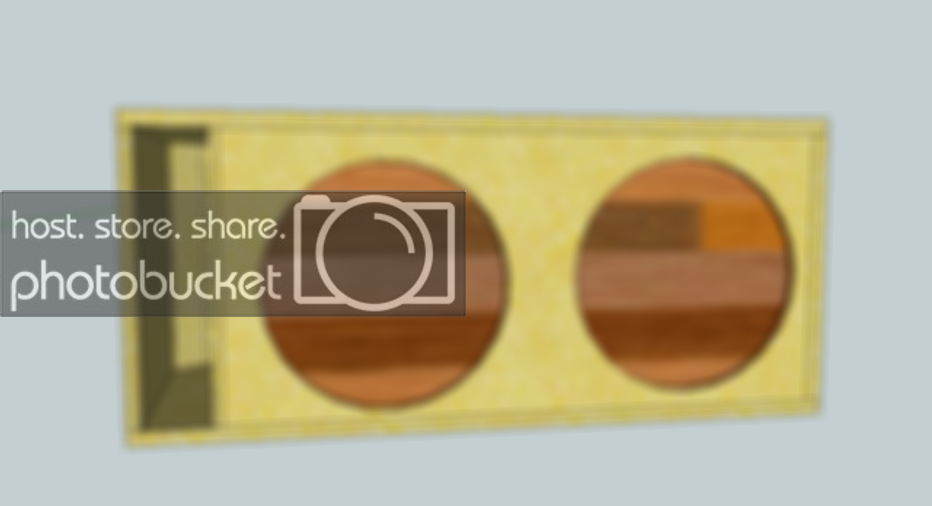

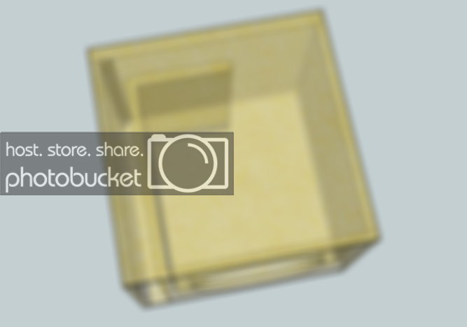

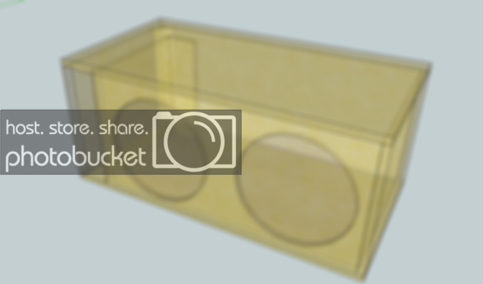

4.7 cubes 33.5hz for some memphis m3's per customers request
1.9 cubes for a hifonics atlas square at 36hz using a pvc pipe as a 45 B-)
2 obsidian 15s at 5.5 cubes 33hz rough draft still designing.

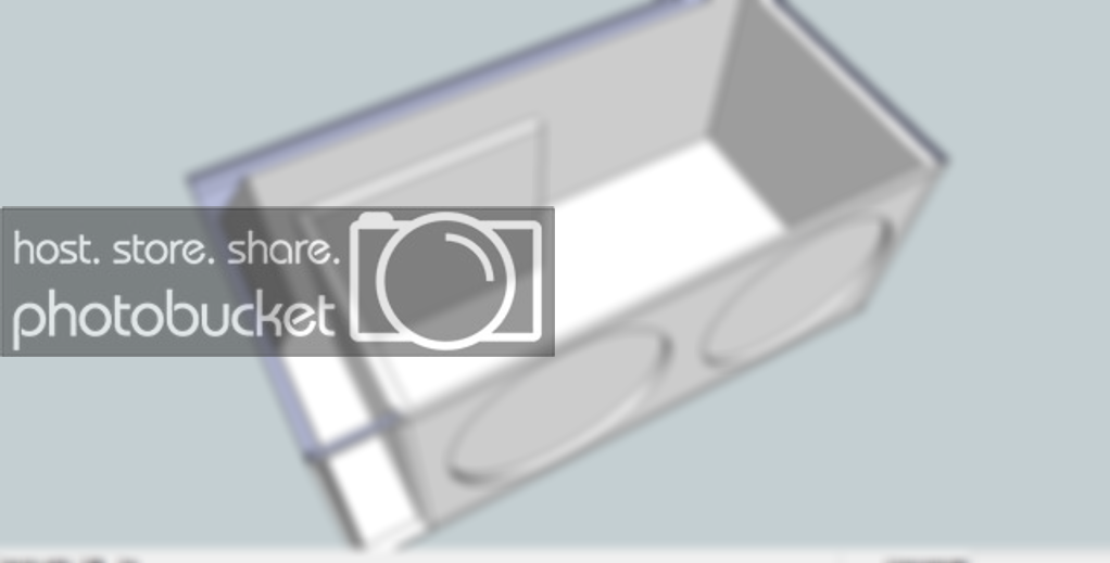

finished memphis box for the night
its ok you keepin it bumped. also if you guys have any ideas on boxes to just show as a kinds ''prefab'' or universal or just to show. lmk //content.invisioncic.com/y282845/emoticons/nerd.gif.c6fa51ddf7ff75f1c0371fbc648f70ae.gif

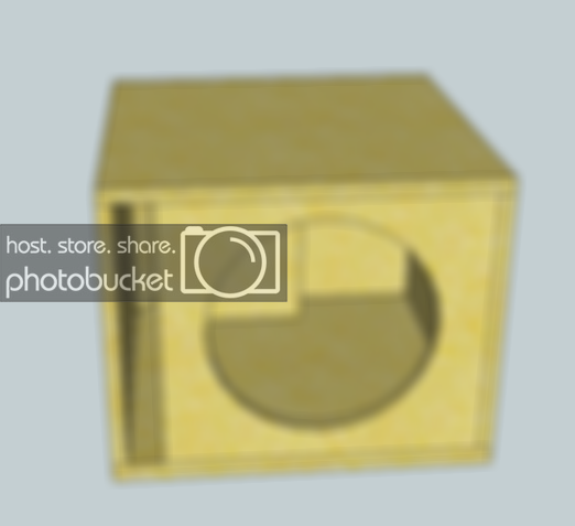

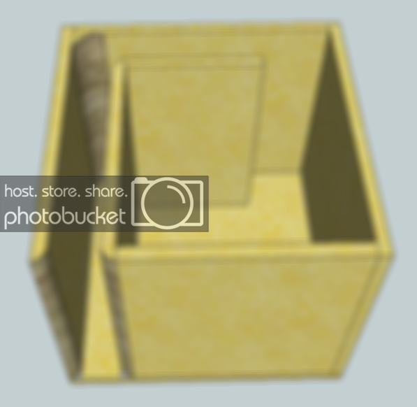

comp vr 12 (2011 model)
20x20x16 port: 14.5h x 2w x 17d then 8 behind the sub. 2.o cubes +-.1 at 36hz
i figured that can also be a universal design for people lurking with their kickers :p

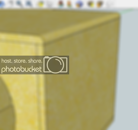

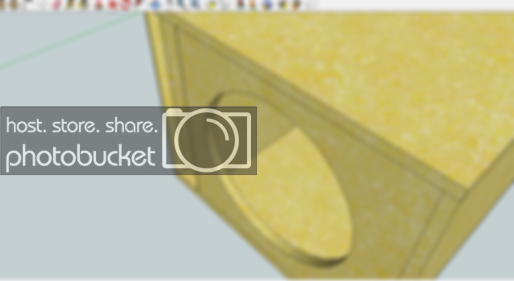

can also smooth edges as i will show in a bit
