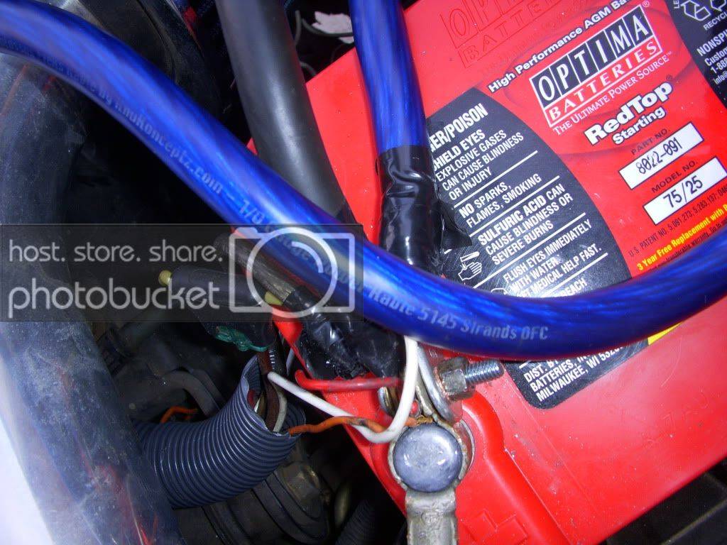

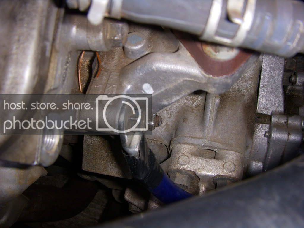

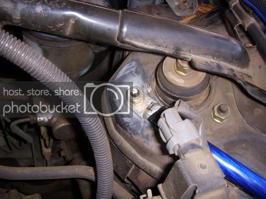

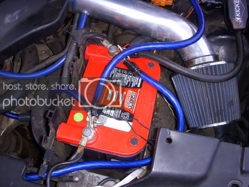

a few constructive comments:
1. run the speaker wire to the door speakers through the factory rubber pathway. this is easy to do and you should have plenty of time. a how-to of door speaker installations is here: http://www.hondaaccordforum.com/forum/audio-visual-electronics-10/installing-door-speakers-sound-deadening-more-32679/
2. thank you for using split loom in the engine bay.
3. color code the power (red) and ground (black) wires at the amp - a roll of red electrical tape is a good thing to keep in the tool box. as-is you can mix those up and then it's *poof*
you mention having spare time. use some of that to route wires neatly and secure them along the way. this effort will make you a better installer. examples here: http://forum.sounddomain.com/ubbthreads.php?ubb=showflat&Number=1369669&page=1# Post1369669
1. run the speaker wire to the door speakers through the factory rubber pathway. this is easy to do and you should have plenty of time. a how-to of door speaker installations is here: Installing door speakers and sound deadening and more - Honda Accord Forum - Honda Accord Enthusiast Forums
those were actually the first thinks i took care of lol. my next car will be cleaner. this is more of an spl learning with the cl models

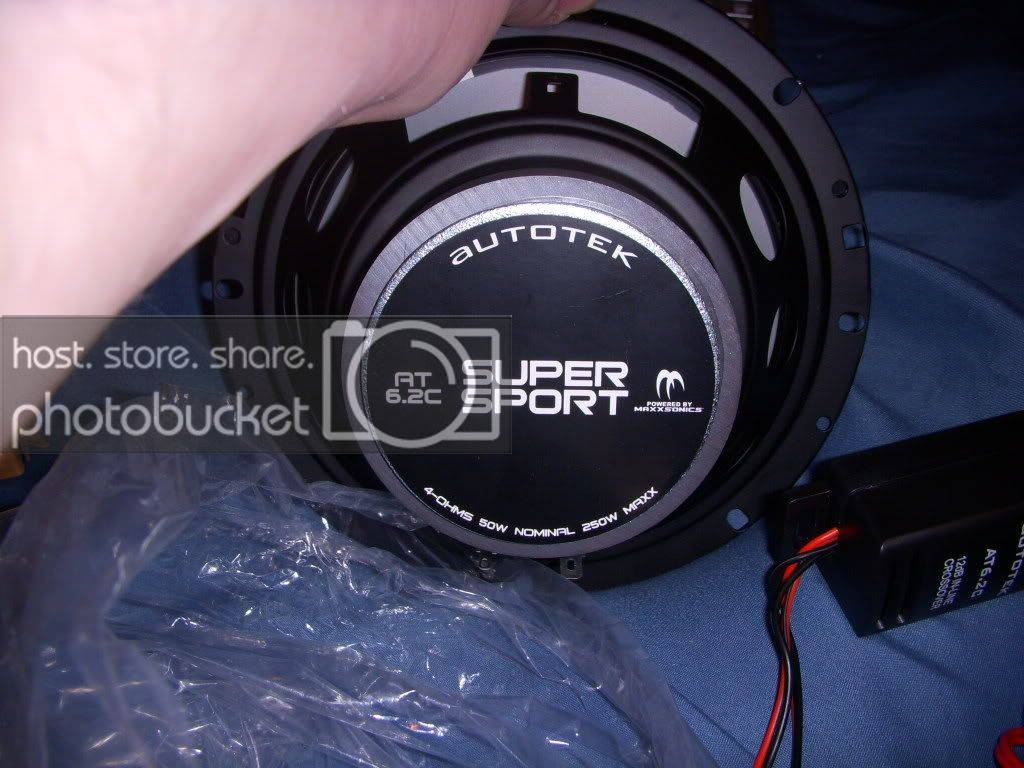

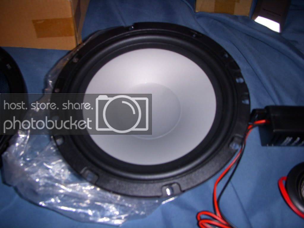

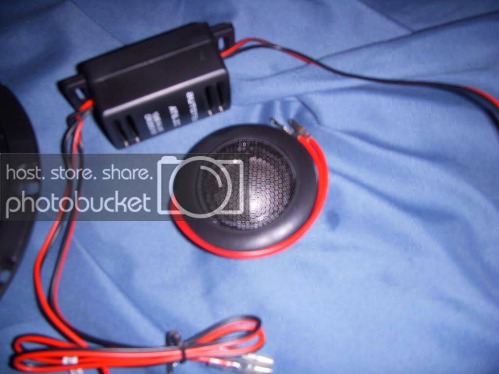

I'm eager to hear how those AT comps are. I just installed some IA 6.5c comps (thanks to Pro-Rabbit) but am still messing with the sound. I might have to get a DSP to fix it....

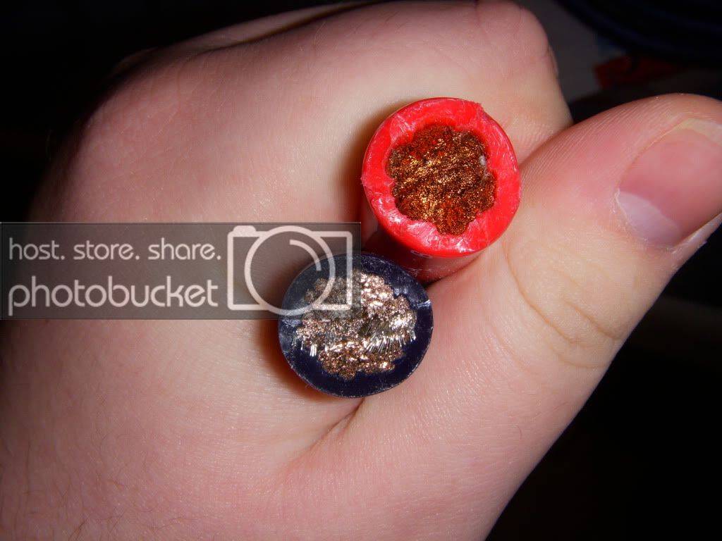

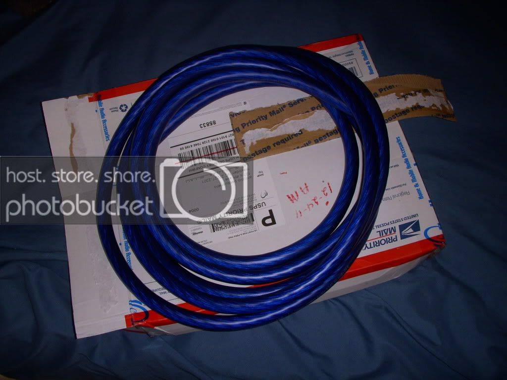

just got a care package from knu //content.invisioncic.com/y282845/emoticons/fyi.gif.9f1f679348da7204ce960cfc74bca8e0.gif 14 ft of ofc 1/0 to replace my big three (i used ca before)

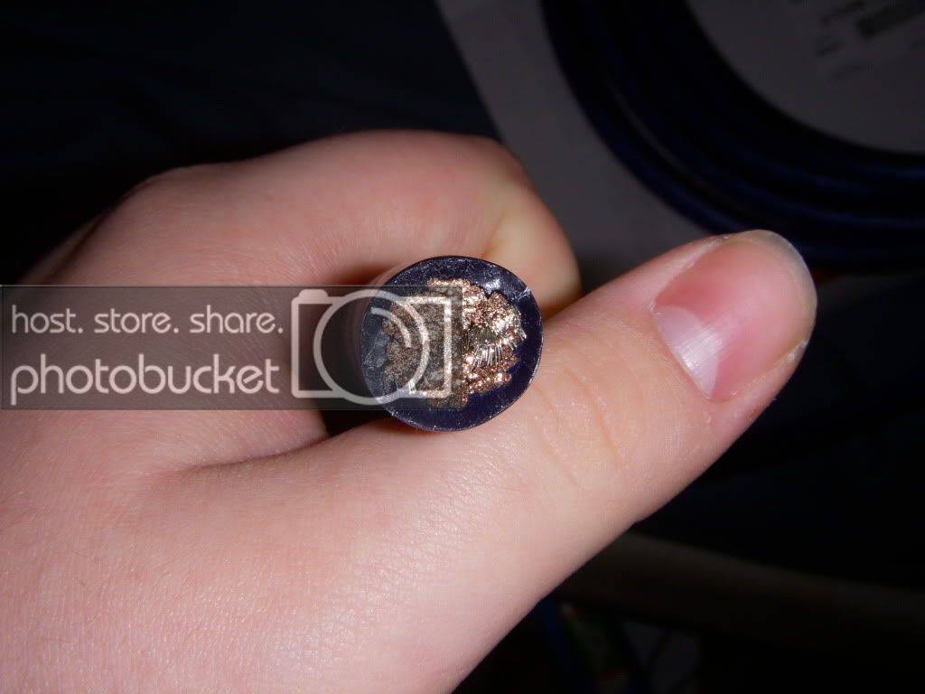

it looks like cca but it isnt weighs a good 10 lbs....
here is ofc efx 1/0 vs knu
