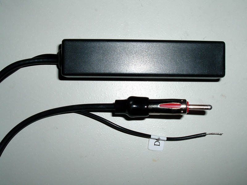

Just to make sure, is this what my power antenna looks like?
Because this is what is plugged into my hu. Its not exactly it, but thats what it looks like
NO, put the switch on the blue antenna wire.
