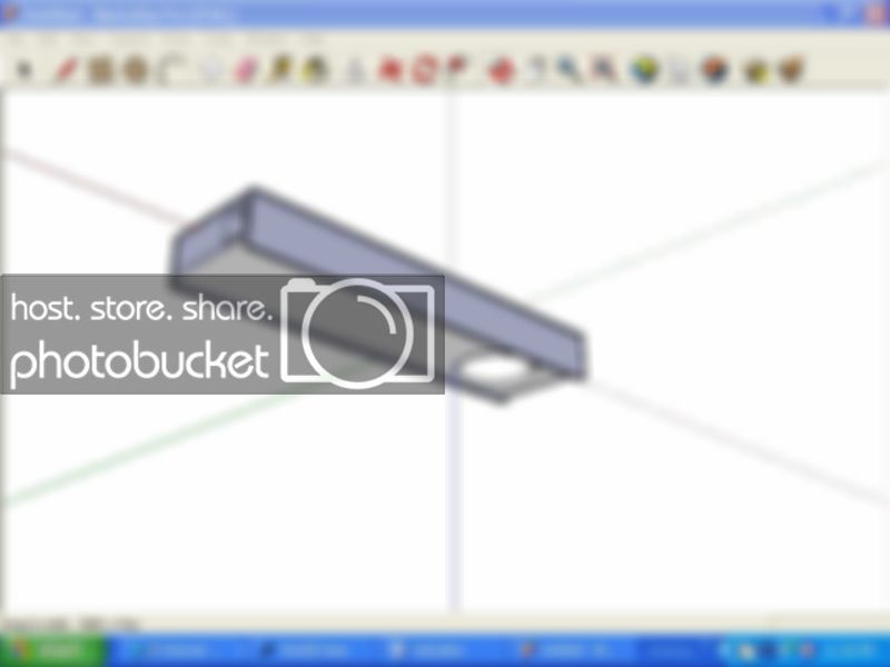

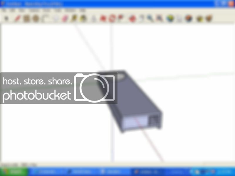

This is what I can up with....
2.77cuft after sub/port displacement tuned @ 38hz
yes very tight.... thanks for your imput. what are the post deminsions ? and what are the benifits of firing the port toward the end of the box? ( instead of firing it up towards the top of the cab? Thanks again your help is very appreciated. oh yea the post dosent have to be squared. i have read where poeple are putting circle ports and 90 degree elbows in boxes to extend ports... is that a bad idea? //content.invisioncic.com/y282845/emoticons/confused.gif.e820e0216602db4765798ac39d28caa9.gif
on a 1 - 10 box builder i am a 6.5 or 7. i am sure i could do A square port but i think the circle port would be easier. i am just needing the specs and where to place it in the box. ( from your drawlings i am assuming that is a port opening on the end )? OH YEA THE SUB IS A POWER PREFERENCE. I like alot of the lower notes ( thats why i chose a 15 and a ported box). Thanks again you have been alot of hlep.....
