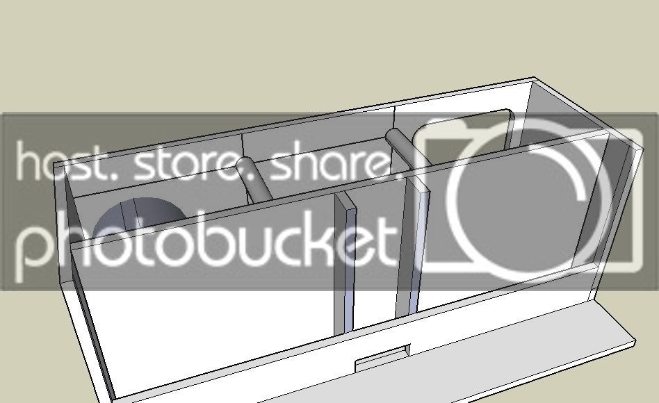

this one would be for a local girl that i work with...as well as a good friend of mine.
it is 3.0 cube enclosure for a single Kicker 05 model L7, with an eighter for a port (no flare though)
it also will house an amprack, with a Viper 500.4 and a Viper 1200.1, along with 4 120 mm PC case fans to keep them nice and cool, and 0/1 going in for power, as well as ground, and a Relay to control the fans, and the rest of the needed speaker wires and whatnot

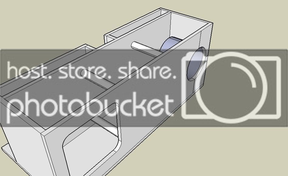

here are a few pics of the design

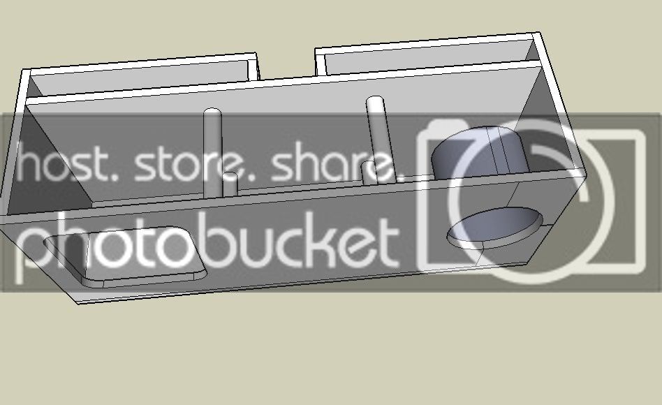

heres a backside shot of the soon to be amprack
Thats a little shot of the bracing that will be in place, 1.5 inch dowels.

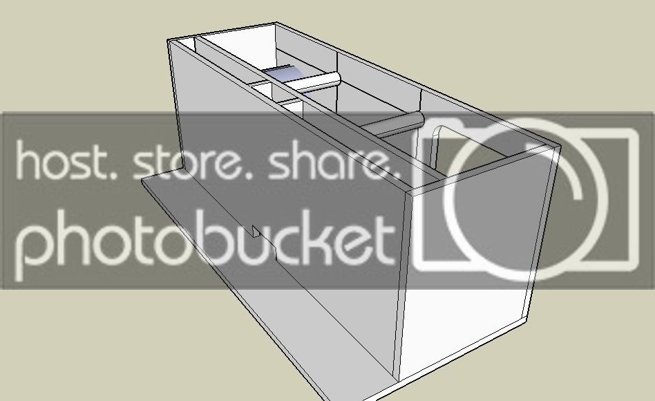

and a final shot.
the build will start tomorrow, and go in until who knows when.
