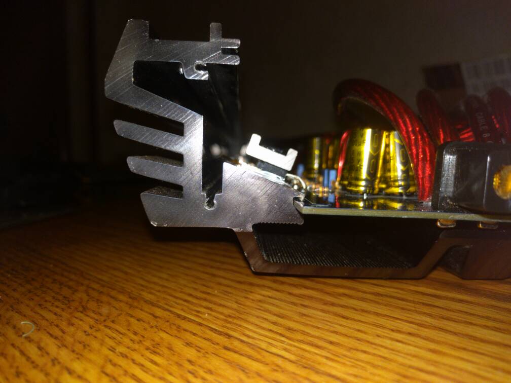

Here's one side of its heat rail. It has a channel that looks like if I fill it in with a 2 part thermal epoxy it could make it more efficient... That little bit of metal that connects it with the outer sink is a joke.
