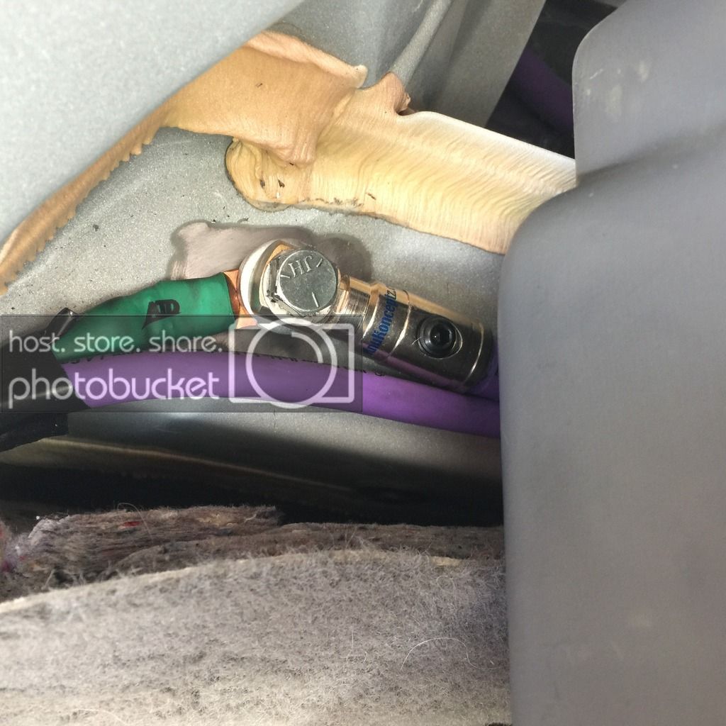

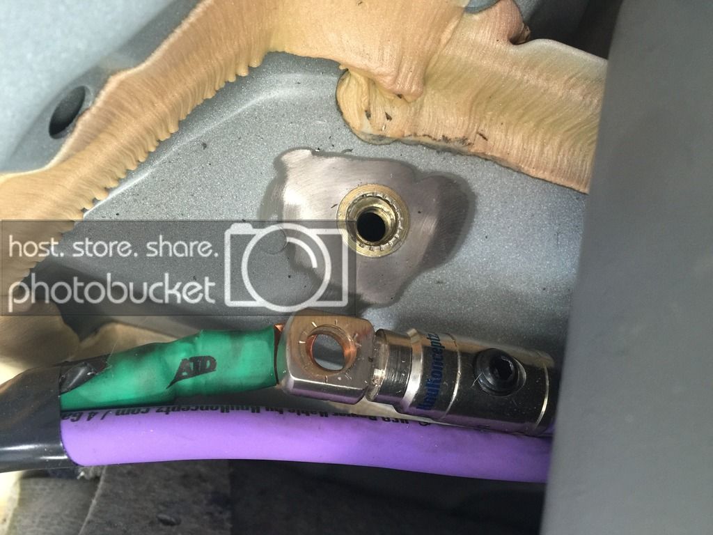

Yes they do share a common ground point - it is however a 3/8" bolt.
Here is with them disconnected
Here they are connected - the bottom is the 4 guage for the 4 channel and the top is 1/0 Knu klossus flex OFC using a Knu lug. The other purple wire is 4 guage power for the 4 channel.

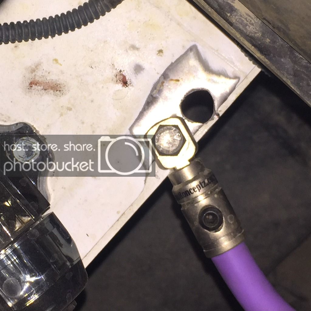

Here is the ground from the battery - using the same wire and method as the back ground in the above pics
