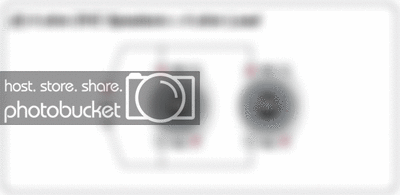

ok well when my alpine amp is hooked up to one of my type r's it plays fine even when volume is cranked but when i hook it up to both subs and i hit a certain volume it shuts off for some reason. the blue light on the amp stays on and doesnt turn red as to go into protect but just shuts off, i then have to turn off my deck and turn it back on to get the amp to work again but does the same when it reaches sed volume.. anyone know whats happening? is it the amp, subs, or something else thats not working right?

the amp is 2ohm stable so i ran both for a 4ohm load not a 1ohm load.

That's true yes. But I'd check anyways. Only takes a couple minutes. I'd go back and check all your connections again. And are you SURE you have the subs wired correctly? Not being a dick, we've all done it.
