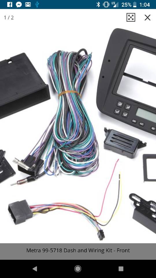

Okay so Ford is stupid and the factory head unit is known as the "receiver" and the actual radio box and stuff is in the trunk. So when you install a head unit, you have to connect all the wires. Well, all the wires are in the trunk, so you have to take the wires that come from a kit when you buy the head unit kit, run it from the head unit to the back of the trunk, then connect the connector from the old wires to the new wires, bypassing the old radio box. Basically, your taking the wires from the factory radio in the trunk, and adding an extension, and running it to the front of your car to the back of the head unit. Sorry if that's complicated I didn't understand it either. One of those wires is the antenna power wire, so I cut the extension wire that came with the kit, and connected the old antenna wire, the new one going to the head unit, and then also connected it to the amp remote turn on. The cables in the photo have an antenna wire extension, and the radio wire extensions, to help with understand what I mean.
