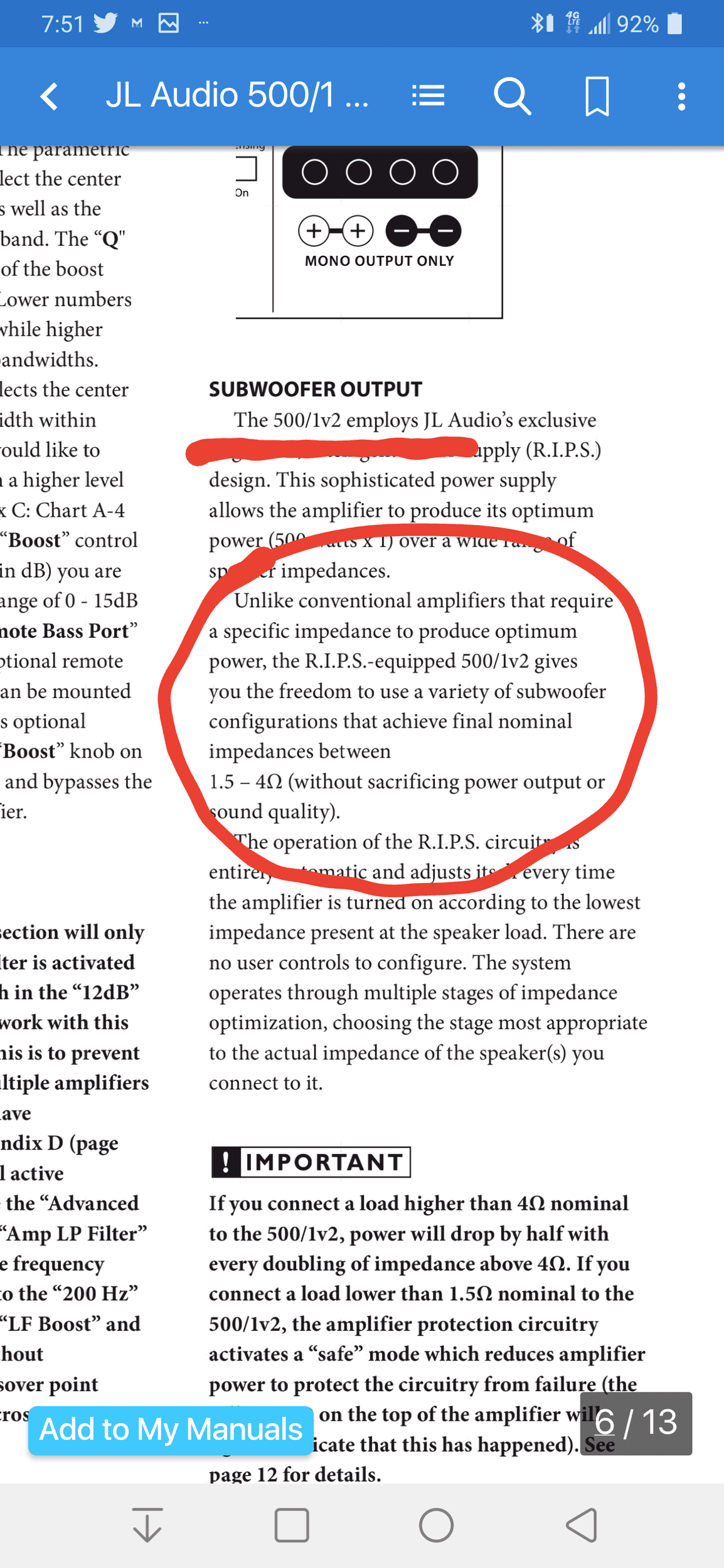

That is because the Slash and HD series put out the same power from 1.5 to 4 Ohms. So no need to pay mind to sub resistance as long as they are within those parameters. You did not mention what type of box you are using on each set. Are the boxes built to each sub's specifications?

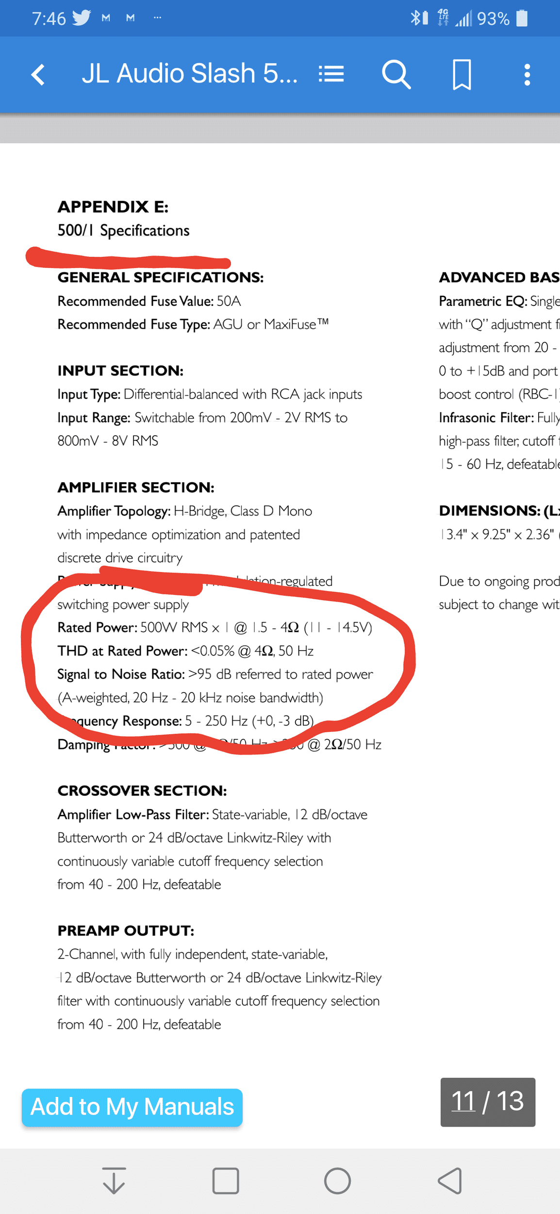

The slash actually does 500 rms at 2ohms and 340 rms at 4 ohms.
The slash actually puts out 500 rms at 2ohms and 340 rms at 4ohms. Per jl specs.
Are you referring to the JD/JX series? The Slash series has no prefix.

Are you referring to the JD/JX series? The Slash series has no prefix. View attachment 46675View attachment 46676
