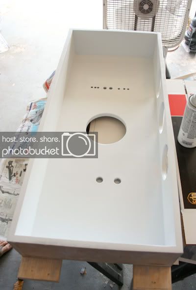

I have completed building an amp rack. I applied 6 layers of primer, 6 layers of white paint, and i am on my 5th layer of clear coat gloss. Before i put on the 6th layer of clear, i was wondering how do i get a "mirror like" finish on the paint.
I read someone else used 2000 grit and then used a buffing compound to get the finish he wanted, but he used didn't use spray paint like i did. Tips? Advice?
This is a picture of the rack without clear coat gloss.

Do not wax paint that is freshly cured... that's a big no-no. Best bet would be to let the paint cure for at least a day or so, then hit it with a wetsand and some buffing compounds. Then after the paint has fully cured, and I mean fully cured from the inside out (several days to a week), then give it a nice coat of wax as you would a car. Should shine like no other.

You can wet sand with about 1000-1500 and then go to 2000 then buff that shit out with some compound and then wipe it down real good with a lint free cloth.
