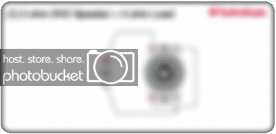

Lol, see this is the problem, they were wired for 4 ohms the whole time and i had em on each channel on my amp (2 ohm min. rockford says) and never had this problem. Only thing different now is that i have a second 4 channel amp for my other speakers, and i have a 4 guage wire run back to both amps and both amps connected with an 8 guage wire (sub amp was on 8 guage before), so i really dont see the problem. Anything wrong with that setup maybe?

I have each sub wired just like this, except hooked up to 2 ohm instead of 4 ohm, but its been like that for almost 2 years with no problems. Now, for the amps being wired to power, i have a 4 guage wire from the battery to my power cap, from the power cap i have 2 8 guage wires, 1 to my 560 4 channel amp and one to my 1800 2 channel amp (the sub amp, and it can only take up to 8 guage wire). That is exactly how everything is wired.
Two subs..... running series-parallel i assume for 2ohms...
