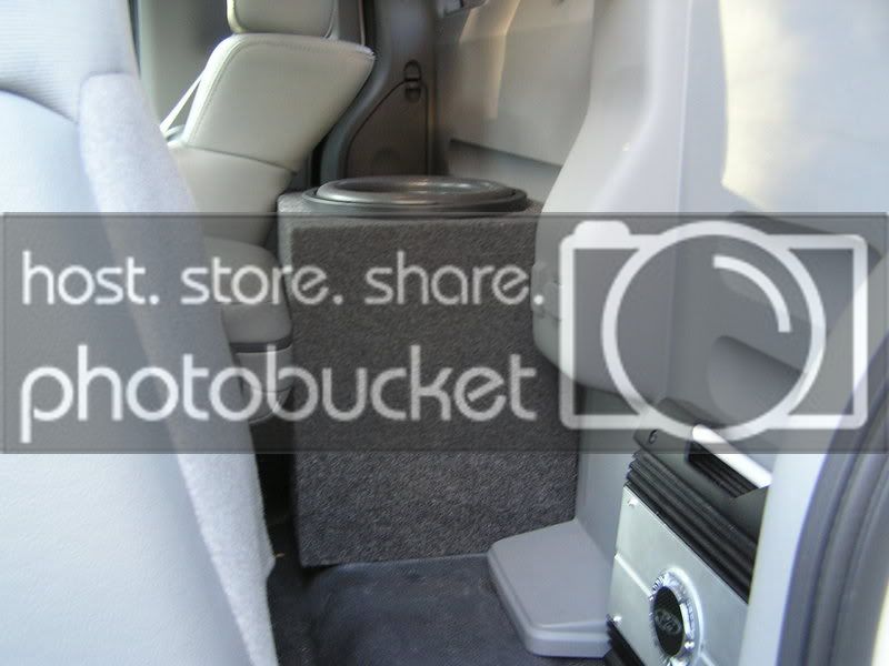

Ok so I got a new sub a few days ago but today as i was driving, i was playing it at a relatively low volume for about 15 minutes and I reach back behind my seat to feel my amp and its really hot. With my last sub (which was smaller) my amp never got too warm but my new SD2 can handle more power and I wasn't sure if that could be why. My gains are at around 3/4, should I lower them?
against the wall
It gets plenty ventelation and during those 15 i had my window down about half way. Should have been getting plenty of air. Does a bigger sub draw more power from an amp? I thought this amp might be a little small for the sub
i had a problem with a viper d1200.1 in the same location. i spaced it off the back wall a couple of inches and it was much better.
Alright I can try that. But why would it be doing this now with my new sub?

you may have to lower the gains a little. amps will get hot though. my xtant gets pretty hot and has for the few years i've had it.
Yeah I know amps do get hot but it was such a little amount of time and it had never happened so i thought I might ask. I'll take it off the wall and put my gain to 1/2
