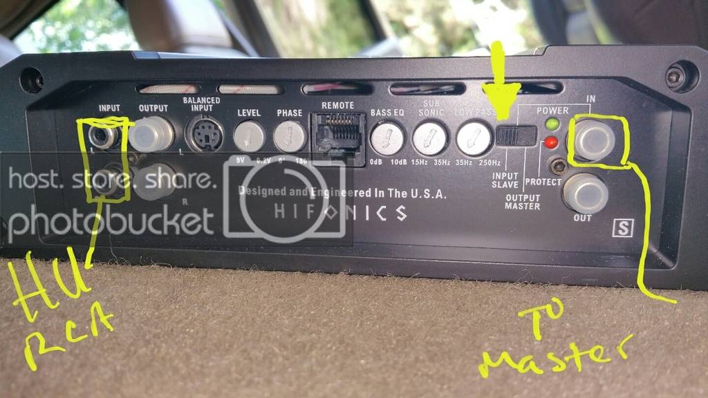

Okay so I just got my two batteries put in the back of my Tahoe and I added a BRX 2000 amp. I think what I'm doing is strapping the amps. I will be running one amp to each sub (2x subs = 2x amps).
-I think I need to run one sub to the master and one sub to the slave.
-Also how close to the back batteries do I fuse? (6 inches etc)
-I also want to make sure I understand strapping these amps. From the manual it says run one rca from the master to the slave. Is it that easy? one cable so they have the same gains and signal ?

I ran a ground from the rear batts to the frame. I also noticed a decrease in the sub power when I connected the slave, since I'm not bridging the subs this could've been my problem. I put both amps as masters, ran a RCA between both amps and gain matched using my CC1. Seems way better, haven't drove around yet with full volume.

I just drove around and the amp I gain matched was cool but that independent sub was smelly. I'm thinking I should treat each sub/amp combo (subs in separate box) as independent setups, Then use my DD1 to set my gains for each amp????
So you attempted to strap these amps without connecting the - speaker outputs of each to the other? You're really fortunate you didn't break those amps. If you don't understand strapping amps just use Y splitter from the HU to the amps and set gains separately.
