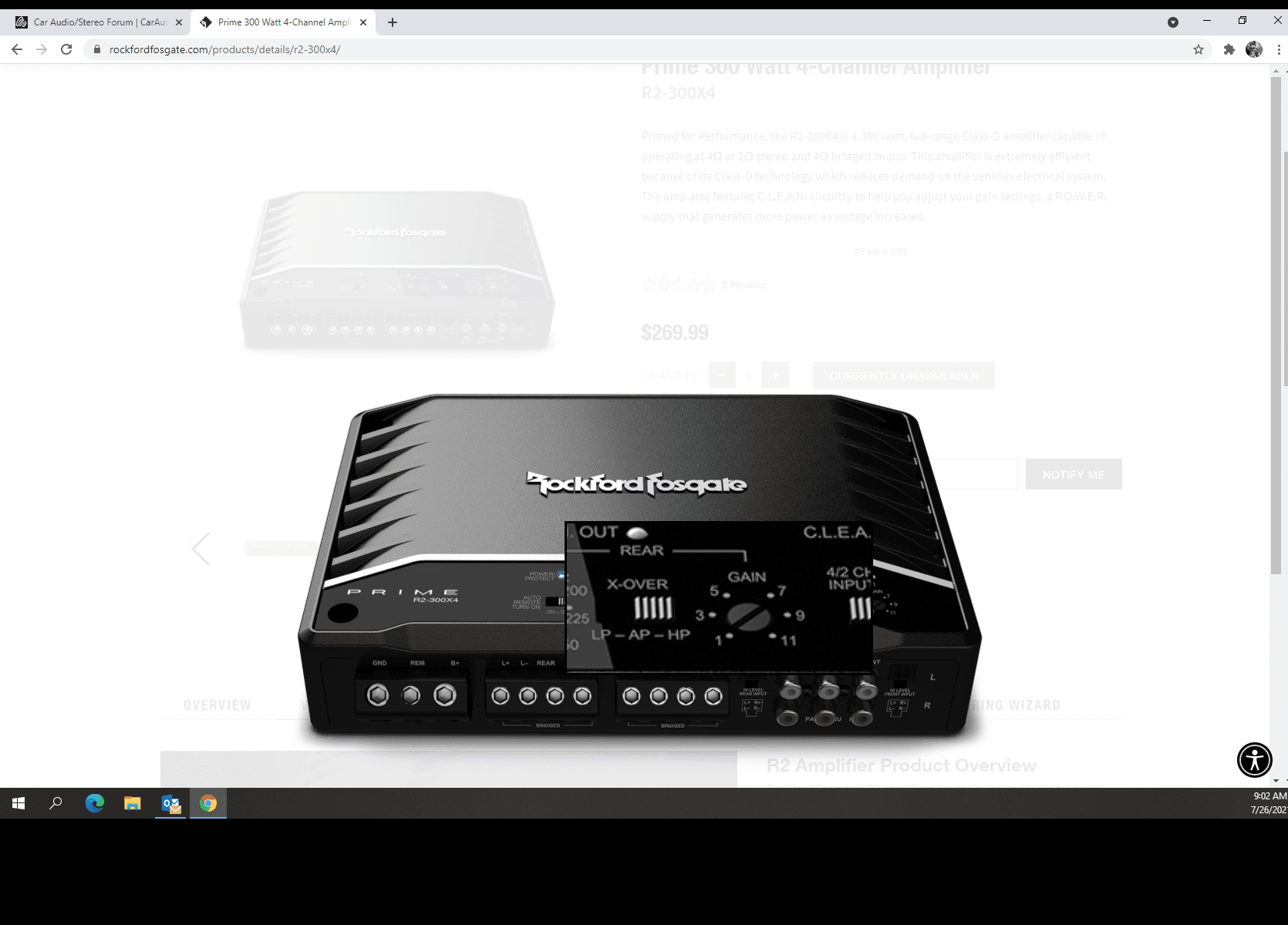

Maybe I am just getting old. But, I have tuned both my amps. RF R2-300x4 set with -5db 100hz. And the RF R2-500x1 tuned with a -10db 40hz. And I am just not seeing the full potential from the sub. Granted its a Kicker L7R in Kicker enclosure. But I have had several single 10's that were lower quality that seemed to get louder. The sub is only rated for 500 watts rms. Thats why I paired it with the 500x1. Should I go up to like 750 or 1000 watts because of box rise?

30966
My gains on both amps are set right at 3 maybe a little higher. Thats where the clip light on the CLEAN OUT comes on.

What I was trying to point out. My headunit says 4v. We all know thats with ideal voltage yadda yadda. It has a max volume of 60. Why, I don't know. Almost every pioneer I have owned has a high volume. Mine distorts at 52. So I tune my amps at 51. Thats when I am getting the cleanest signal from my head-unit. But I usually listen to my music at 25-31 volume. So I tried to gain match my amps at 35 volume. The signal coming into the amps were clean. But I was able to turn my gain to max gain without any distortion at that volume. Meaning its probably putting out less than .2v from the headunit at that volume. So both amps were tuned by to headunit volume of 51, gains matched for no distortion.
The R2 amps have the clean setup. I marked the clean in at 40hz and 100hz. 40hz clipped at 53, 100hz clipped at 52. So I stuck with 51. The 300x4 is tuned utilizing a 100hz -5db tone and the 500x1 is tuned with 40hz -10db.
What I was trying to point out is that the gain is not a volume knob. It is a gain match. Allows me to match my headunits voltage out to the amplifier. Thats why at 51 volume, my gains are at 3 on the amps maybe a little higher. Not much. But at lower volume I was able to max out my amps gain, because my output voltage was pretty much non existent.
