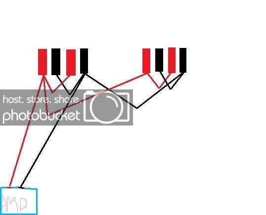

am i wiring my subs correctly? pic inside..
MmatsDude
just wanted to know if am wiring this 2 dual 4 ohm alpine type r's correctly, am a bit confused since all the 4 terminals are on one side of the subs. I am wiring them to 1 ohm.
another last question
my mono amp has 2 negatives to the left and 2 positives the other side. Were does the negative and positive go? since theres 2 neg and pos...
No not in this situation.PM sent for proper use of the Y splitters for this situation

Wire to the 2ohm diagram as shown for the MTX subs on the one amplifier you have. That amp should do very well on those two subs. alpine make some...

Sure, 600 volts, yep. If you’re trying to launch the subwoofer cones to the moon! And, that’s if they don’t just vaporize first!

Sell the dual 2 and get another dual 4.
