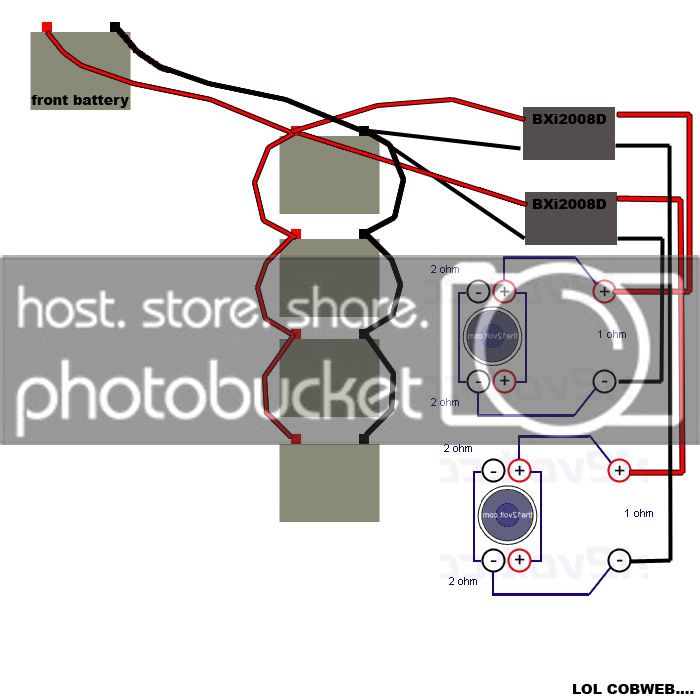

Am I understanding this?
Gearstix
yeah its messy.
But is this how I'd do a multiple battery setup on my truck?
I was just playing around with the idea of two BXi-2008s.
Do you really need that many batterys for 4kw? A simple D3100 or 2 will do the trick, but yes you have the right idea. Although you might want to strap the amps if they have a master/slave option.

I didn't plan on strapping the amps, just running one amp per sub.

You can buy a powermaster d3100 off jegs.com for $3XX shipped, if you plan to run the amps as you say you are, make sure you get a very accurate voltage meter and make sure both amps are putting out the same amount of volts if the woofers are in the same common space enclosure.

Hmm. Would I be better off strapping them?
One D3100 would do the trick, but it would probably be cheaper for me to buy the 4 Orbitals. I'm in Canada and shipping isn't free here.
Lol sorry it sucks as a diagram.
One amp per sub. Not trying to ghetto bridge it..
LOL I SEE IT NOW. Sorry. I'm tired. It will be done proper when its hooked up.
So I just run it from the front battery, to the battery bank. then Positive to amps, ground to amps, right?
I've never done multiple battery setups, or negative runs so this is all new to me.
