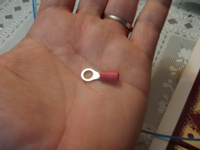

Well my plan was to run 1/0 to a marine battery and connect them with O ring clamps, then branch from the battery terminal with 4 gauge to each amp, then strap the amps together with the rca's, this is the terminal im using
connected by these O ring clamps:
and thats my plan //content.invisioncic.com/y282845/emoticons/smile.gif.1ebc41e1811405b213edfc4622c41e27.gif lol
I'd suggest some 4awg copper ring terminals assuming you actually thought those little things would actually work on the wire.. Ace has them for a buck a peice or so. The packaged ones are alot more money.
I know. lol thats just a pic i found. those arent the ones i was looking at.
