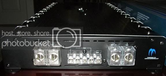

thw autotek amp i have is basically 2 mono amps in one case that will be run internally strapped at 2 ohms for 4000 watts. so ill have 2 full runs of 1/0 fropm the battery, i just wasnt sure if i should use a dist. block and run the kicker amp off one of the 1/0 runs or should i run another full run of wire from the battery to the amp. I also done really know what size fuse to run in each of the 1/0 runs.
here is the power hookup on the amp

I would run two 1/0ga wires and one 4ga wire. There isn't a whole lot that a distro block will do for you since I don't know if even 4/0ga has the capacity of two 1/0 and a 4ga wire combined. If it does then you could use a couple distro blocks, otherwise....you're gonna have a lot of wires.
Technically speaking you could splice a 4ga off one of the 1/0ga wires and it should work. How well, or what effects it will have is speculation and depends on a whole lot of factors. I just would eliminate any chance of something going wrong and wire it up right the first time.

since i already have 1 run of 1/0 that i had my other amp hooked to im gonna leave that and just run it to a dist block and run the 4g from that and then run 2 more runs of 1/0 for the autotek, i just need to know what size fuses to use and wether a 200amp alt and a red top will be enough.
