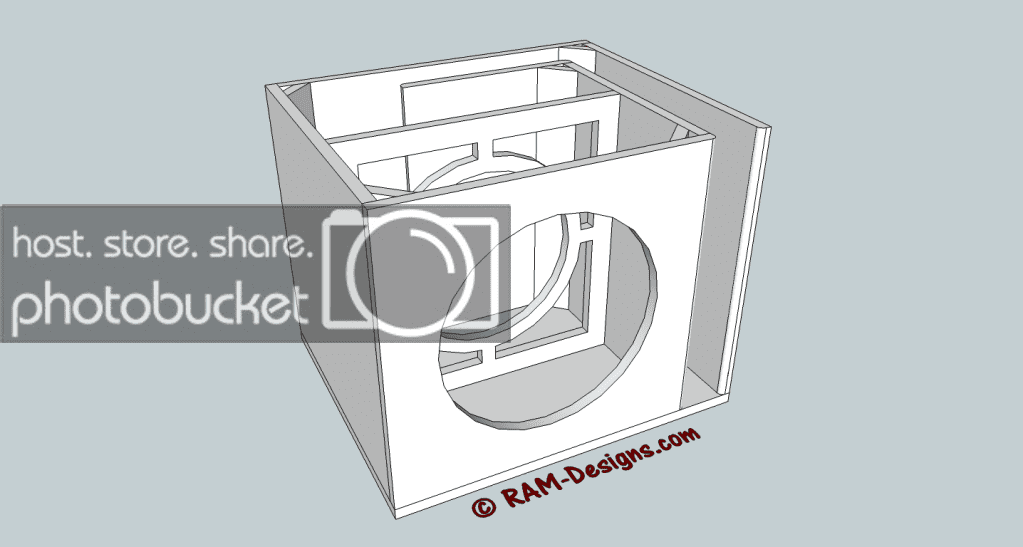

They're just used to brace the larger and more necessary pieces of the box. Window braces this this work great because you can use one piece of MDF to brace four walls.
But dowels or all-thread would probably be better for spl setups to allow for smoother air flow around the bracing structure. For daily though, where you're not chasing numbers, window style braces work great from my experience.

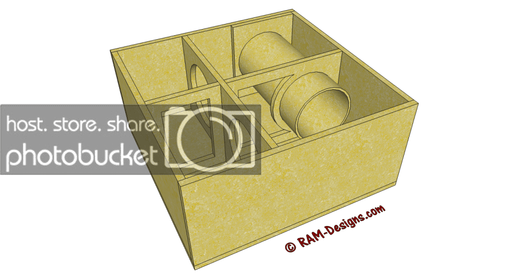

you have some nice looking box designs
Why thank you. I've been crazy busy lately...got 4 more design requests today. I need to crank at least a couple out tomorrow to try and catch up. //content.invisioncic.com/y282845/emoticons/crap.gif.7f4dd41e3e9b23fbd170a1ee6f65cecc.gif
