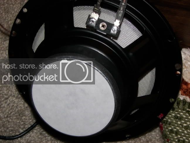

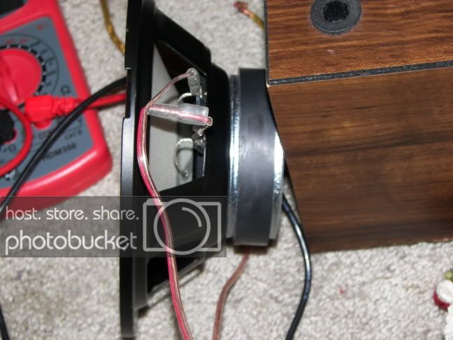

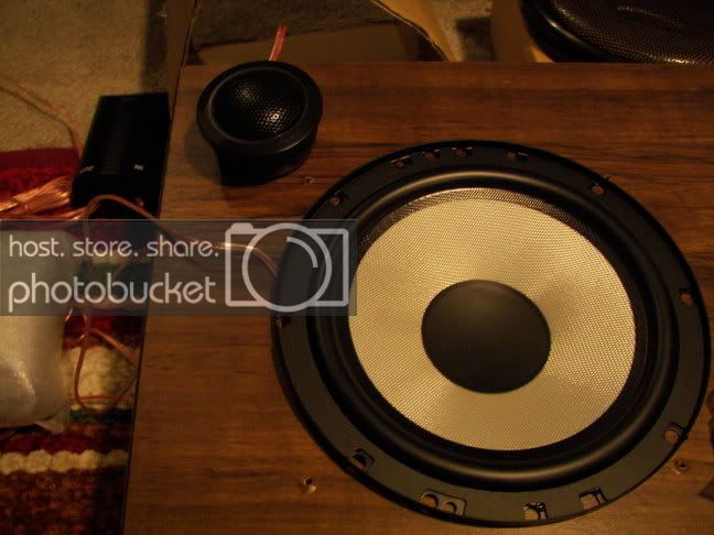

Alpha Component set Prototype 1:
Woven white Kevlar cone, textile dome, pretty basic but decent crossover...
Question of the day... Should there be a phase plug on the lowest end set or not? This will have about a $10 impact on price...

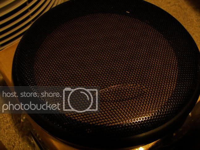

Grill... We need to make a cool little logo...:

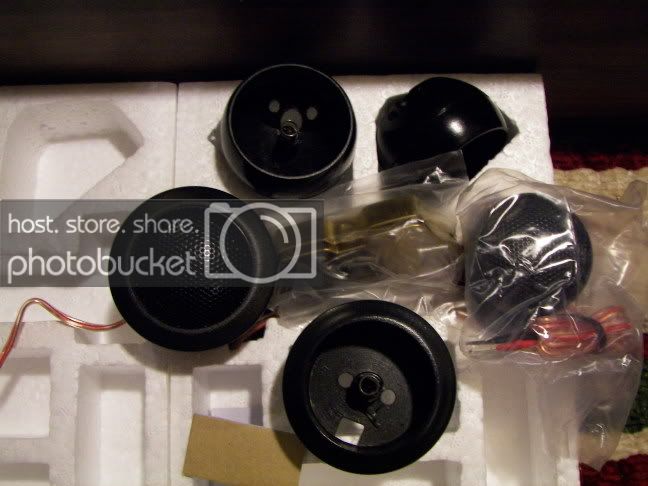

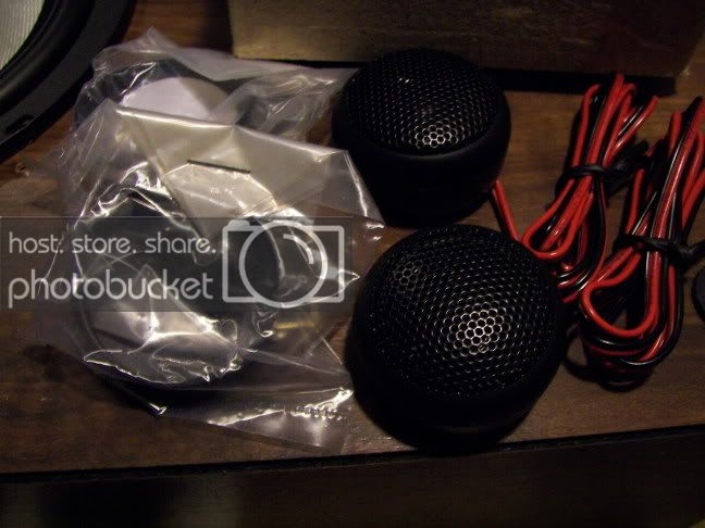

.75" silk dome tweeter, not quite sensitive enough for the Delta but they have a very refined sound.
This silk dome tweeter is a definite step up from the set used with the basic Alpha set and seems to be the right tweeter for the Delta component set. It makes a great drop-in replacement for the Alpha's tweeter and I think it would be worth it to use this as the standard tweeter for the upgraded version of the component set.
The basic Alpha component set is 2.5" deep, ~92dB/w though I haven’t had a chance to make sure the t/s are as simulated yet but it sounds to be about the simulated sensitivity so at least we are in the right ballpark.
Power handling is a mere 40 watts if you want to avoid going too far over xmax when you consider the high sensitivity and a 4th order high pass at 80hz... You should be fairly safe with up to 80-100 watts if you are just smart about it (turn it down if you hear too much distress). The midrange packs a whopping (hah… pretty typical though at this price though… Alpine Type X has 3.15) 2mm of xmax, also the set as-is is turning out to be a little less expensive than we thought so instead of $80 being the intro price, $70 may be in order assuming we get the reaction I'm expecting and we can justify a higher quantity order. $109 is the MSRP.
The modified motor design will make the midrange 2.8" deep and drop sensitivity to ~91dB/w though it will have 6mm of xmax and include 2 short paths with an aluminum phase plug as well... We are waiting to hear back about pricing on this though I expect the price to be in the $170 neighborhood with the same tweeter as the delta, $260 retail. Power handling is a full 120 watts mechanical, not to mention distortion will be extremely low given that it has a Kevlar fiber cone, phase plug, saturated pole, saturated top plate, and the 2 short paths.

As for the cone color white, black, and blue are all options… What would you prefer?
