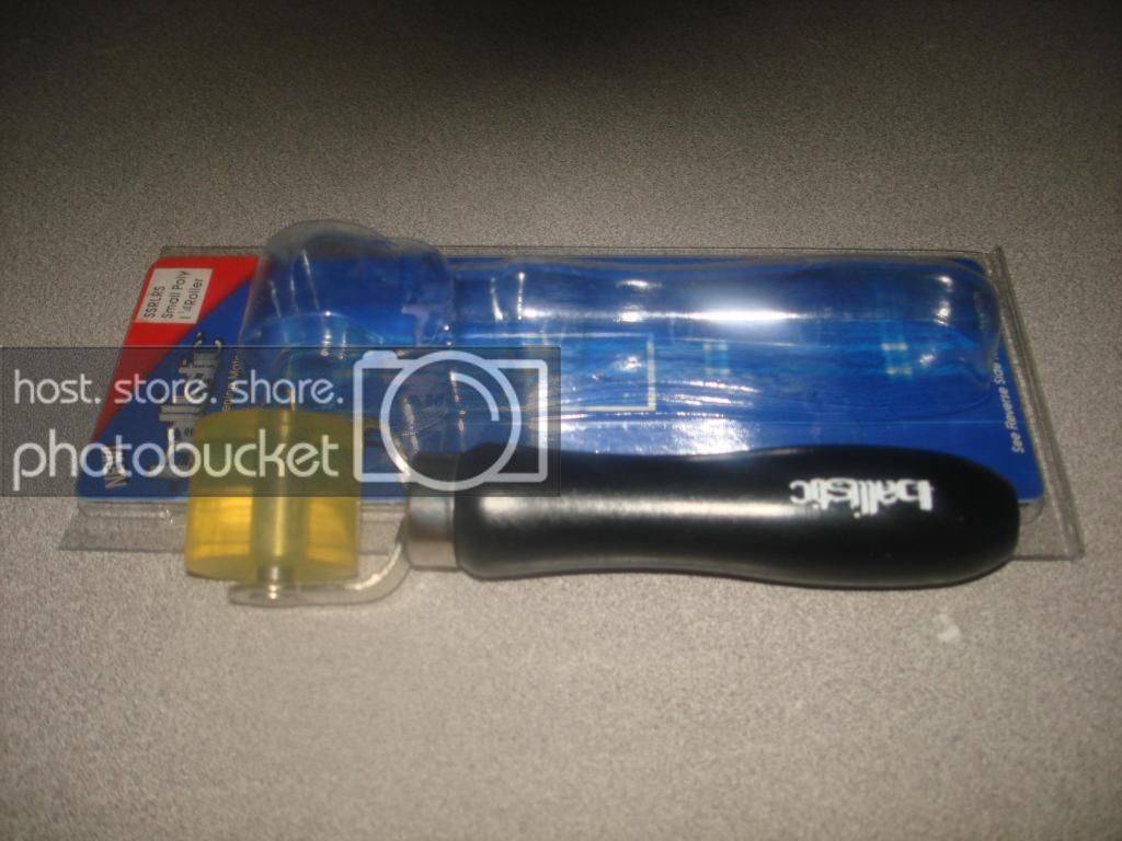

1-A sturdy urethane roller

The urethane roller makes shaping the cld tile over uneven surfaces or ridges in the panel so much easier to manipulate.

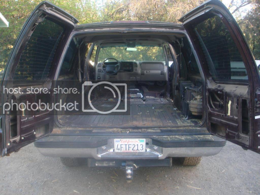

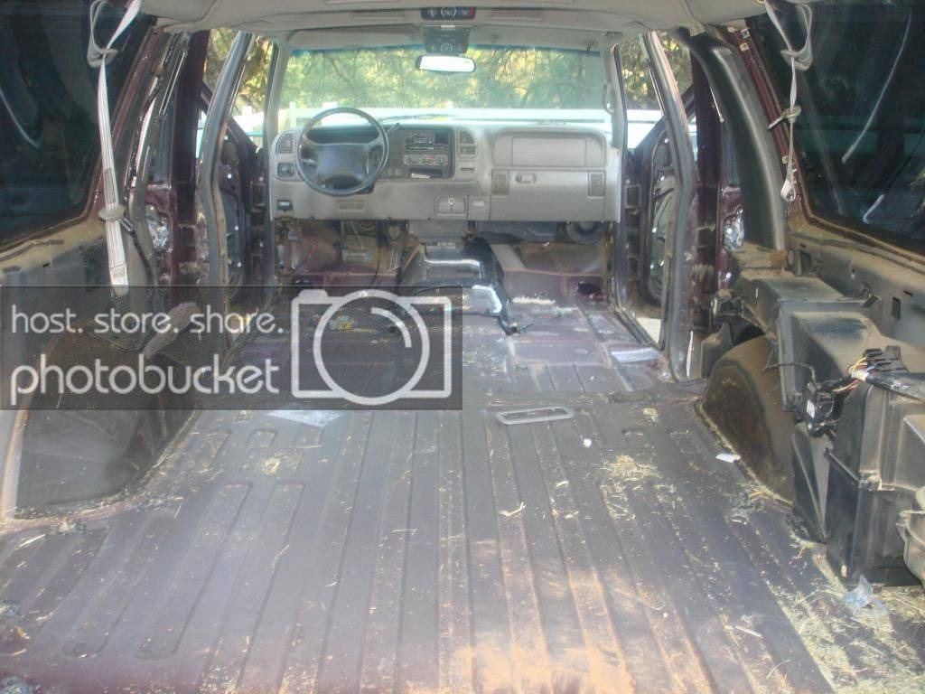

My starting point.

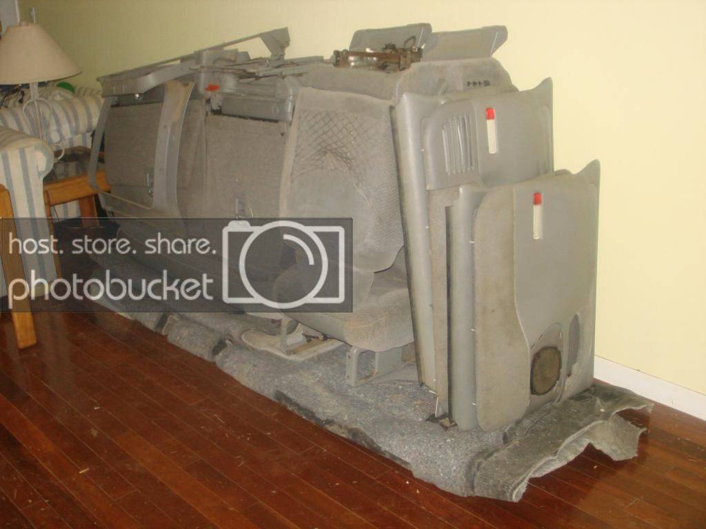

All my interior components removed.
Now you see why I only want to do this once.

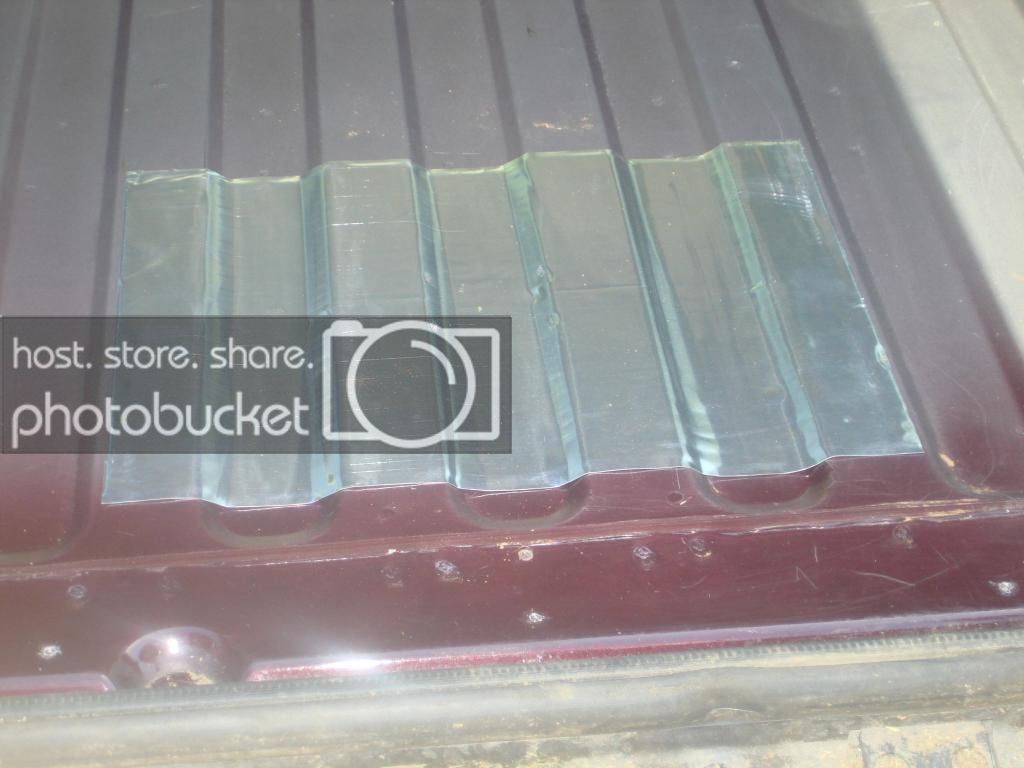

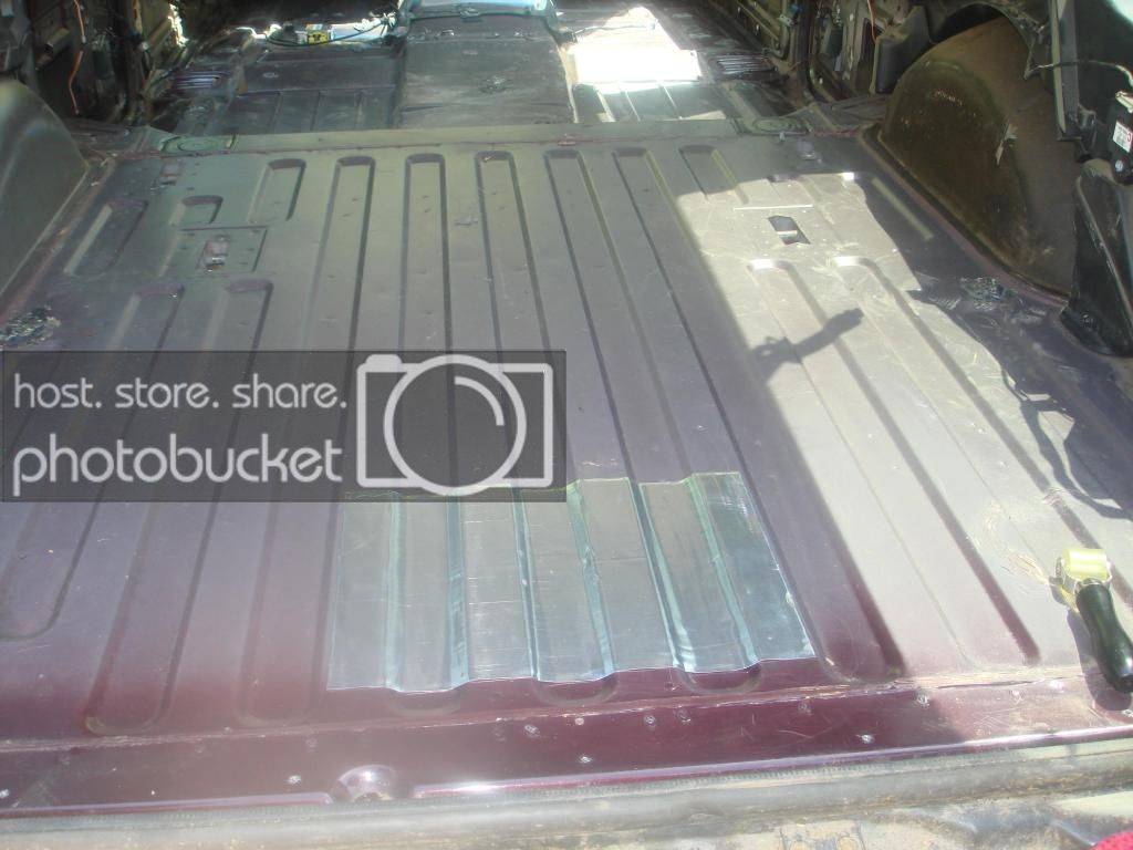

First area to begin with.
First Alpha Damp tile installed.
Close up of first tile.
Roller used to perform the install.

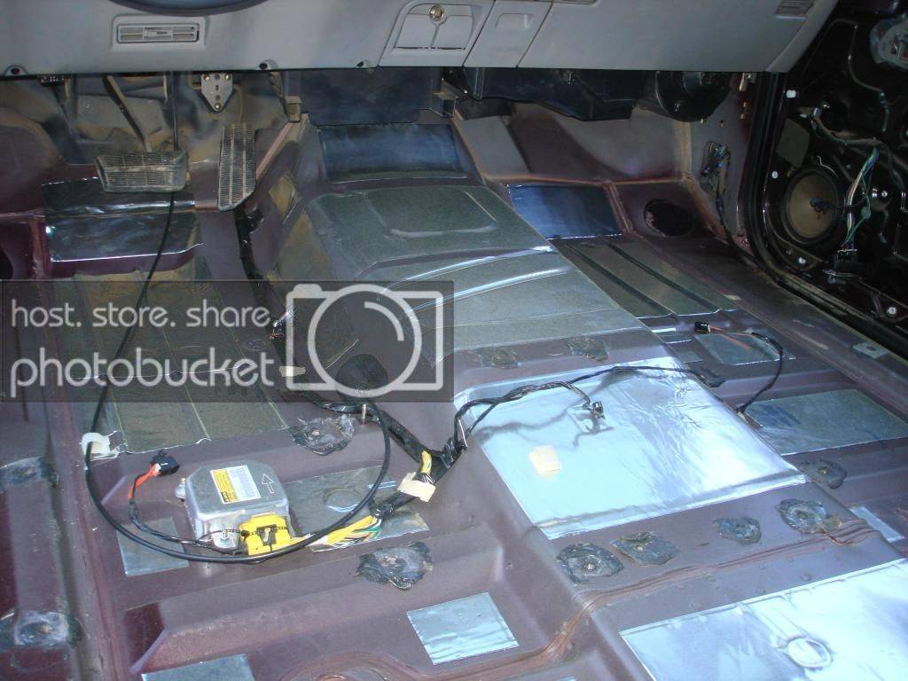

Here's some more pics of my Alpha Damp installation.
Once again I am very pleased with the way this product goes down but I'll let the pictures speak on Alpha Damp's behalf.
Bret
PPI-ART COLLECTOR

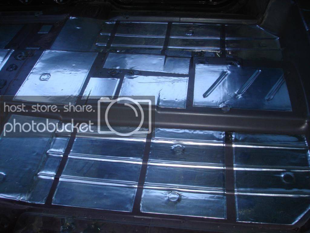

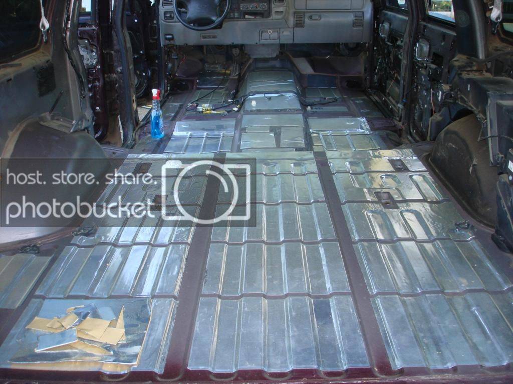

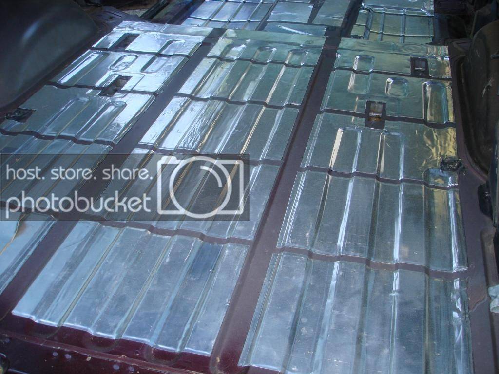

40 sheets now installed.
Another angle at the rear.
Front area all tiled up.
Transmission hump covered.

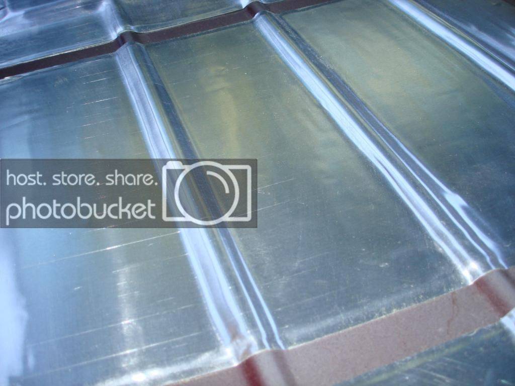

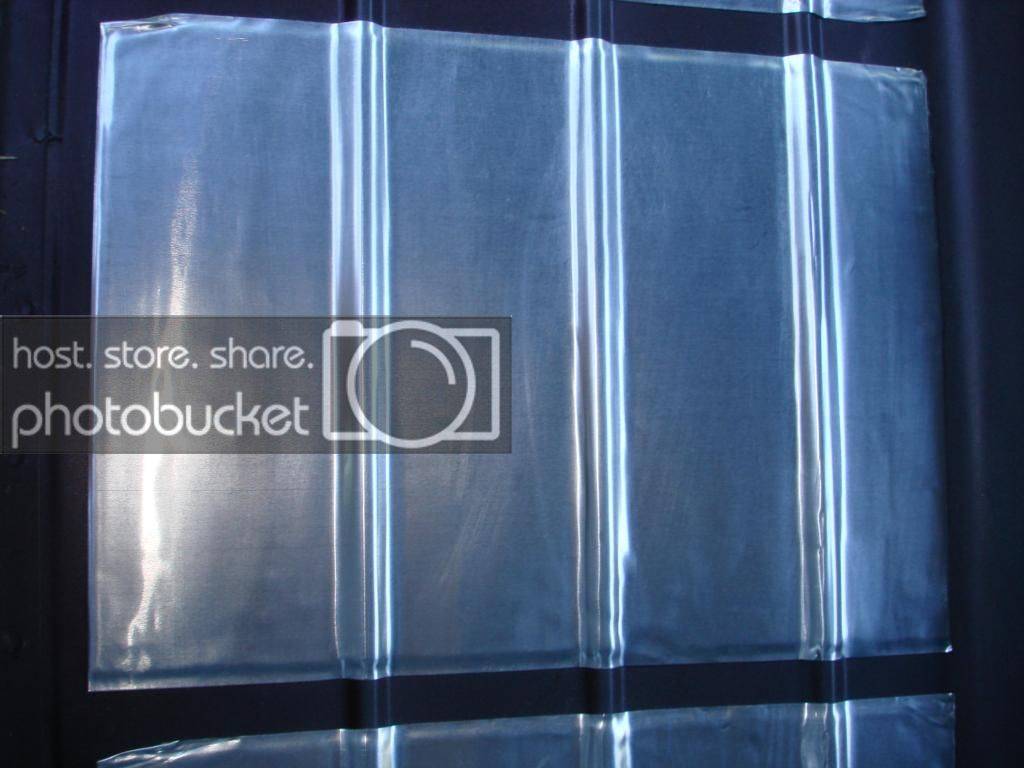

A great picture of just how well Alpha Damp lays down and adheres to the floor.
Close up of the same tile.
Just look at that crisp line around the panel ridges and the edges of the Alpha Damp foil.

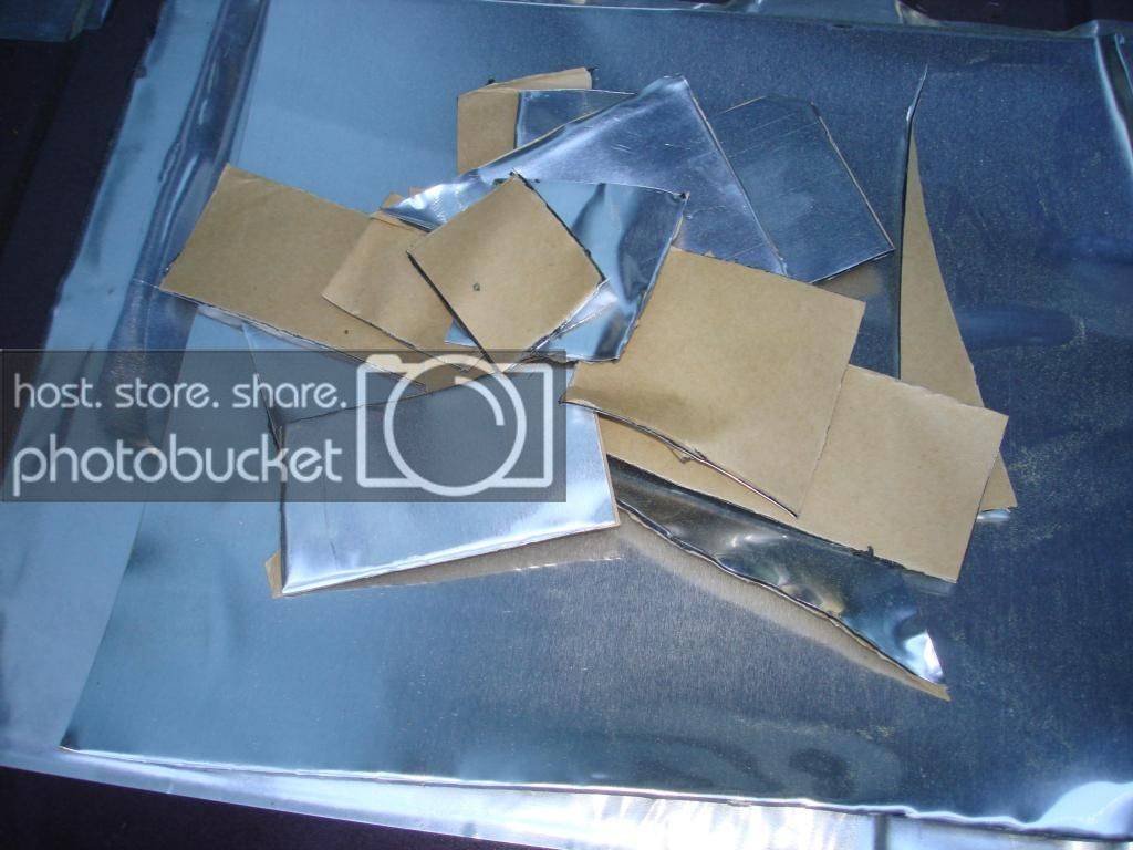

The only scrap pieces left after 40 sheets.

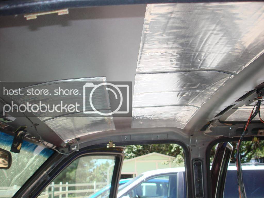

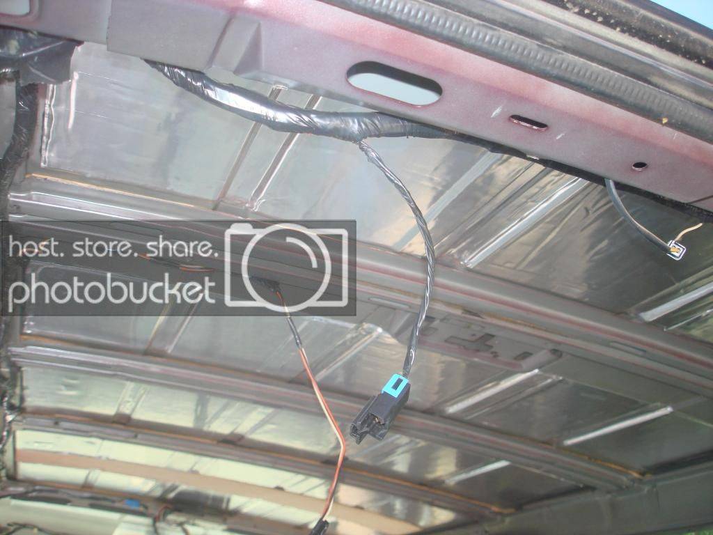

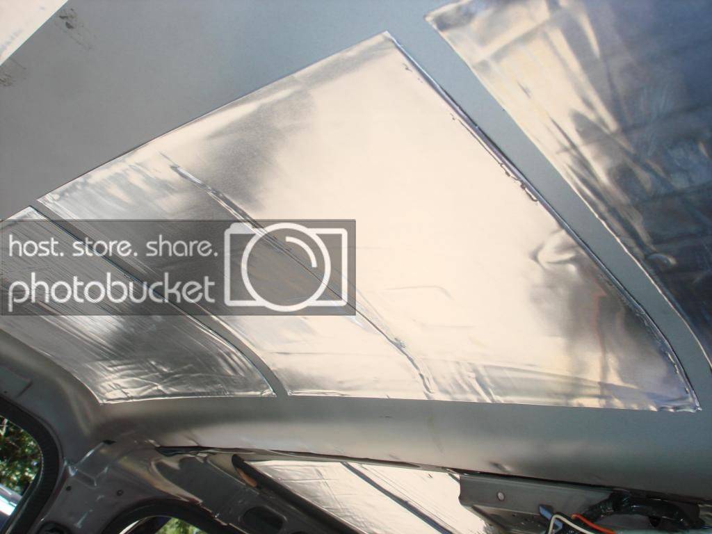

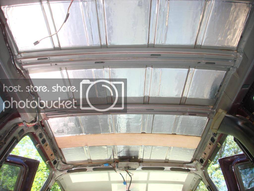

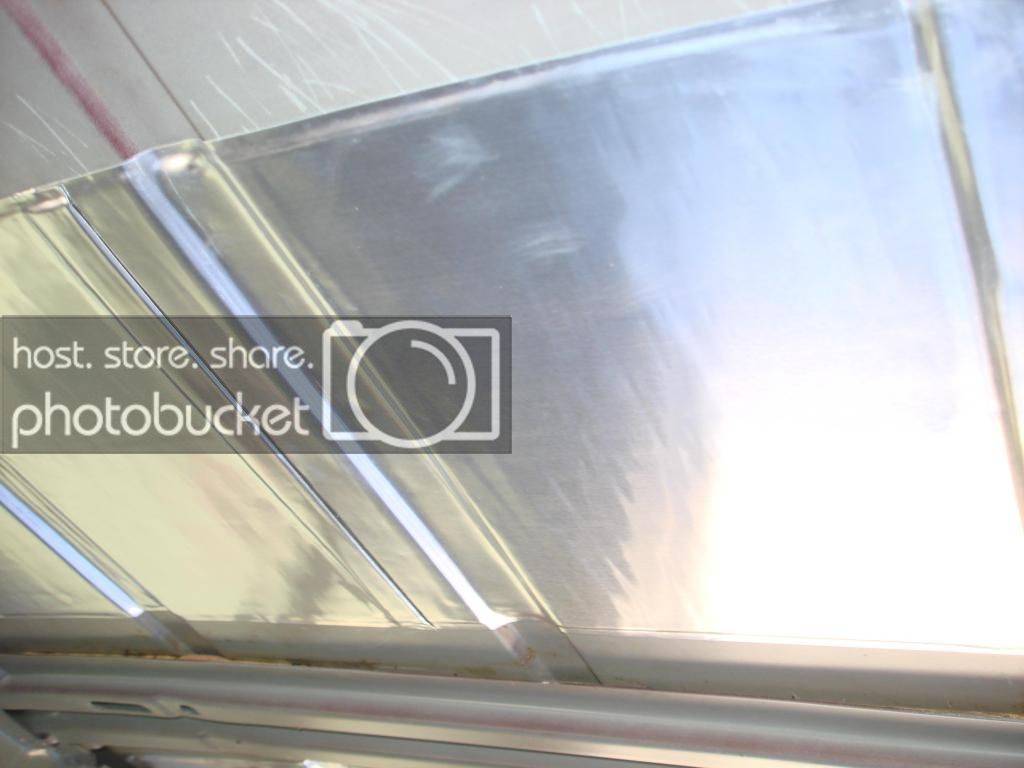

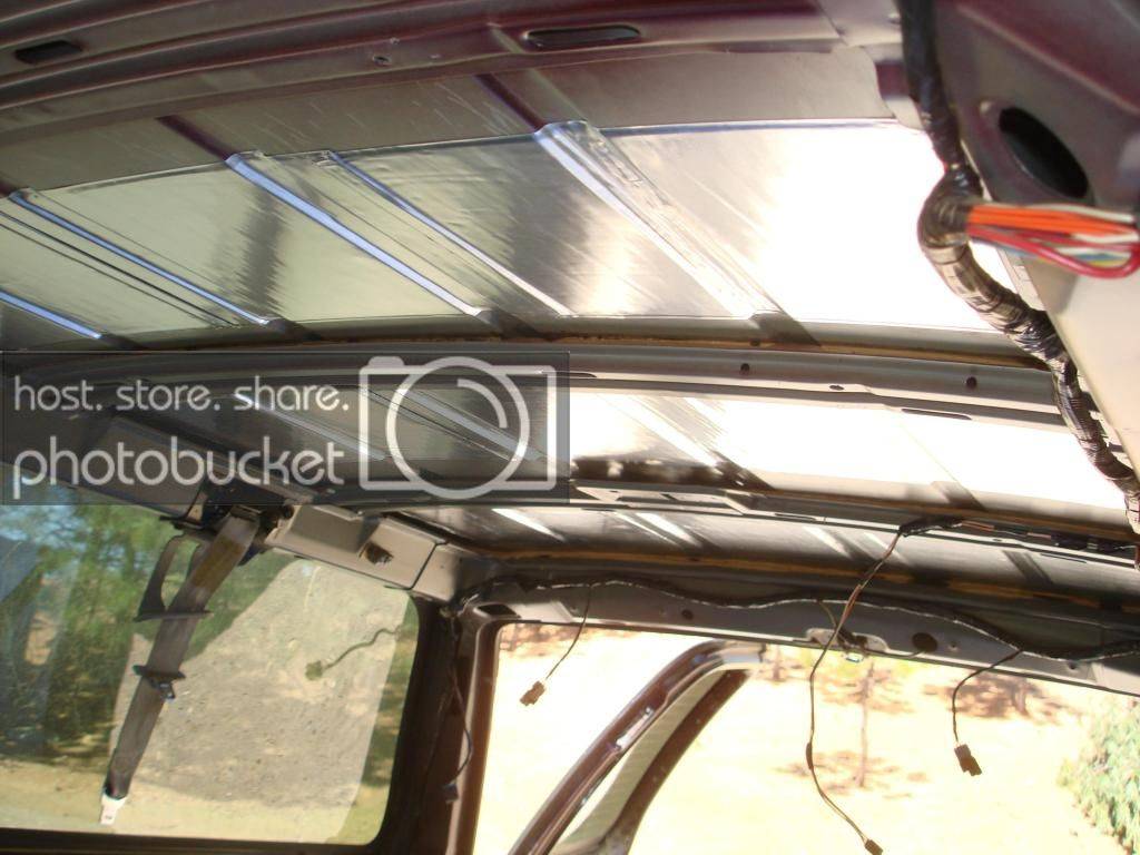

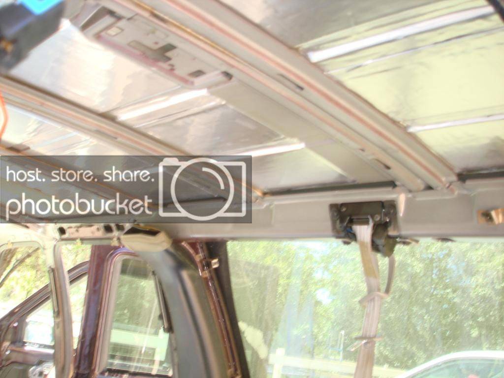

I just finished installing 20 sheets of Alpha Damp in the Suburban's ceiling.
I'm just one tile short on finishing the ceiling as you'll see in the pics.
I have a new found respect for those of you that do this for a living.
Rolling cld tiles on the floor is one thing, but rolling them down in the ceiling is quite another.
The results from the tapping test were nothing short of amazing considering the roof line is over 15' long and the sheet metal is thinner than the floor.
I will post the demonstration video once it finishes uploading to youtube.
Next stage will be installing Alpha Damp in all six doors and the two inner quarter panels and then it's onto MLV installation. //content.invisioncic.com/y282845/emoticons/biggrin.gif.d71a5d36fcbab170f2364c9f2e3946cb.gif
