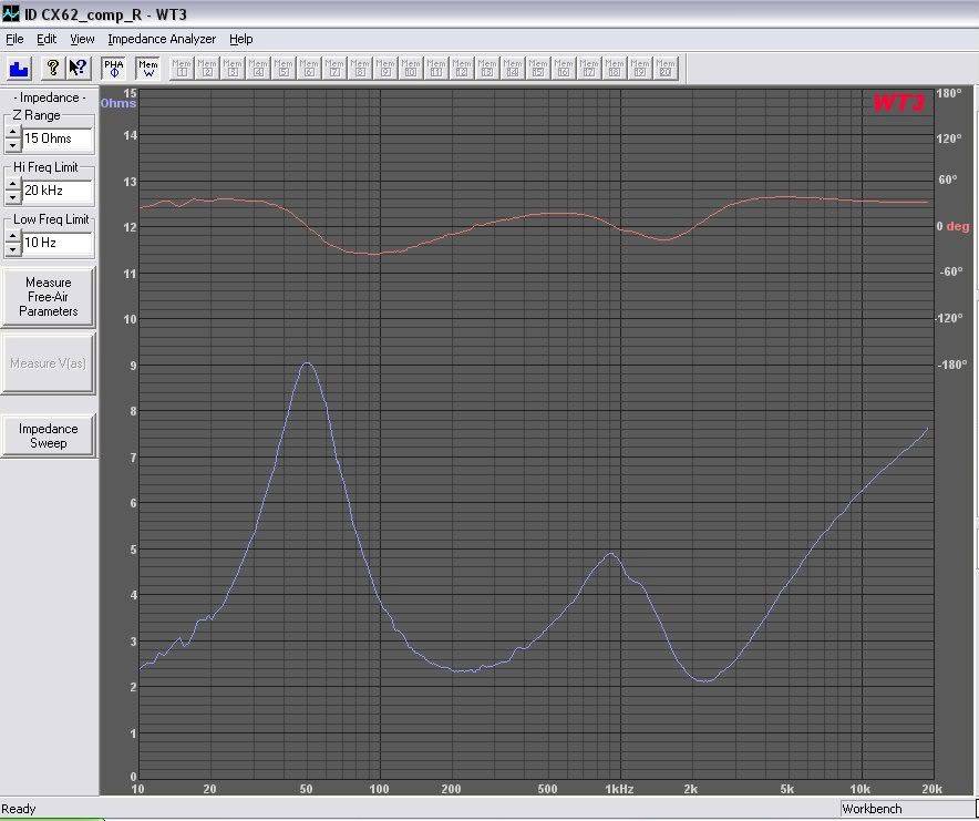

This is a measurement of an Image Dynamics CX62 2 ohm woofer and a 2 ohm tweeter through the supplied crossover. Notice that it isn't 2 ohm very long or often. But the minimum impedance is referred to as the nominal impedance to offer safe amlifier operation.

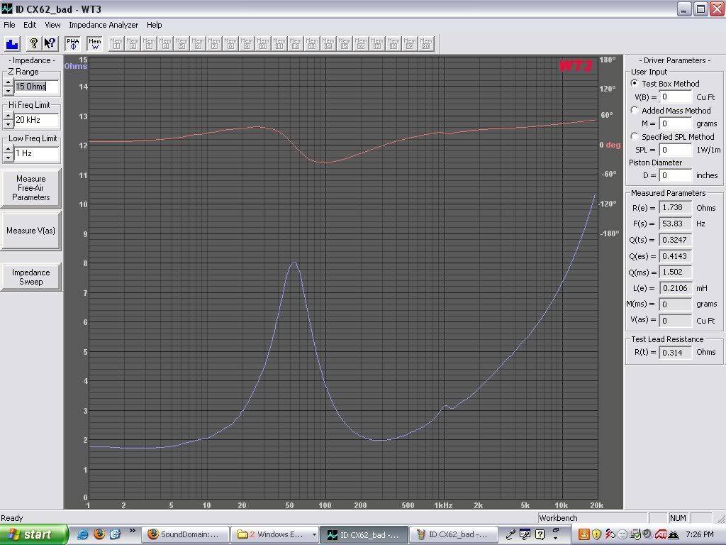

This is the CX62 by itself
