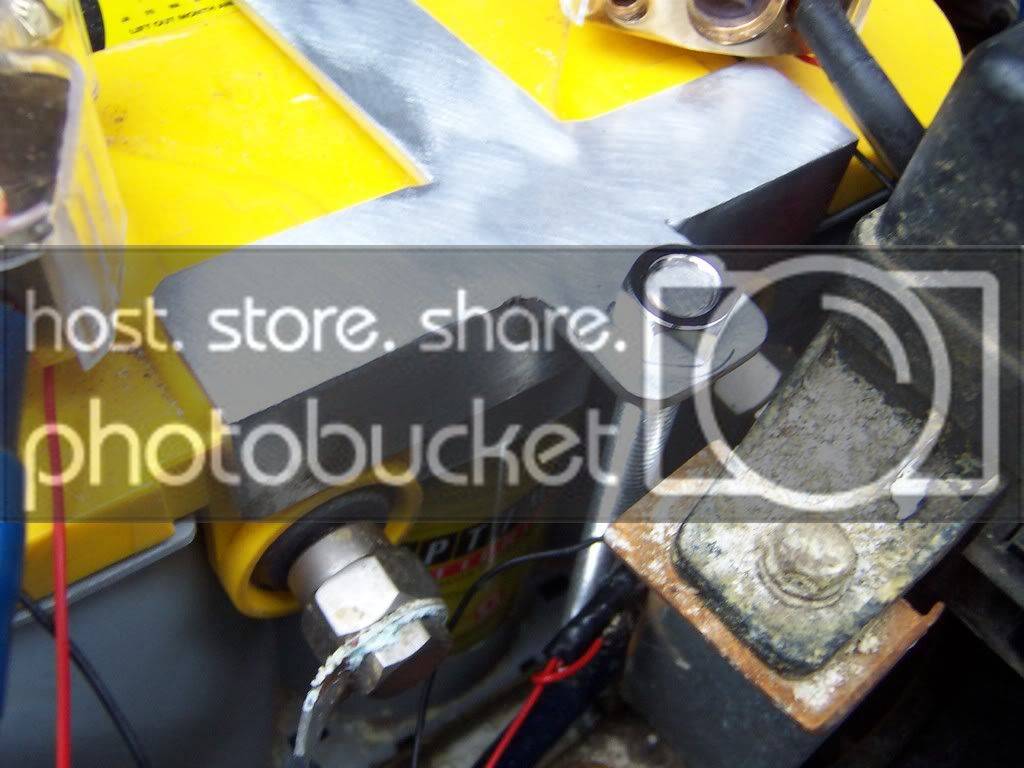

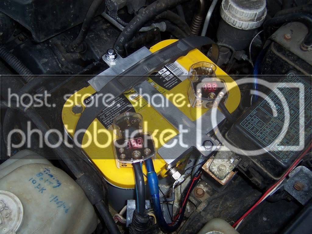

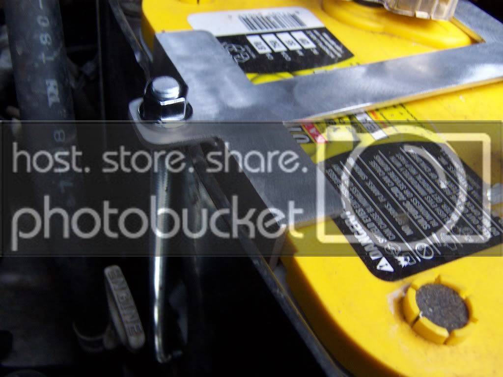

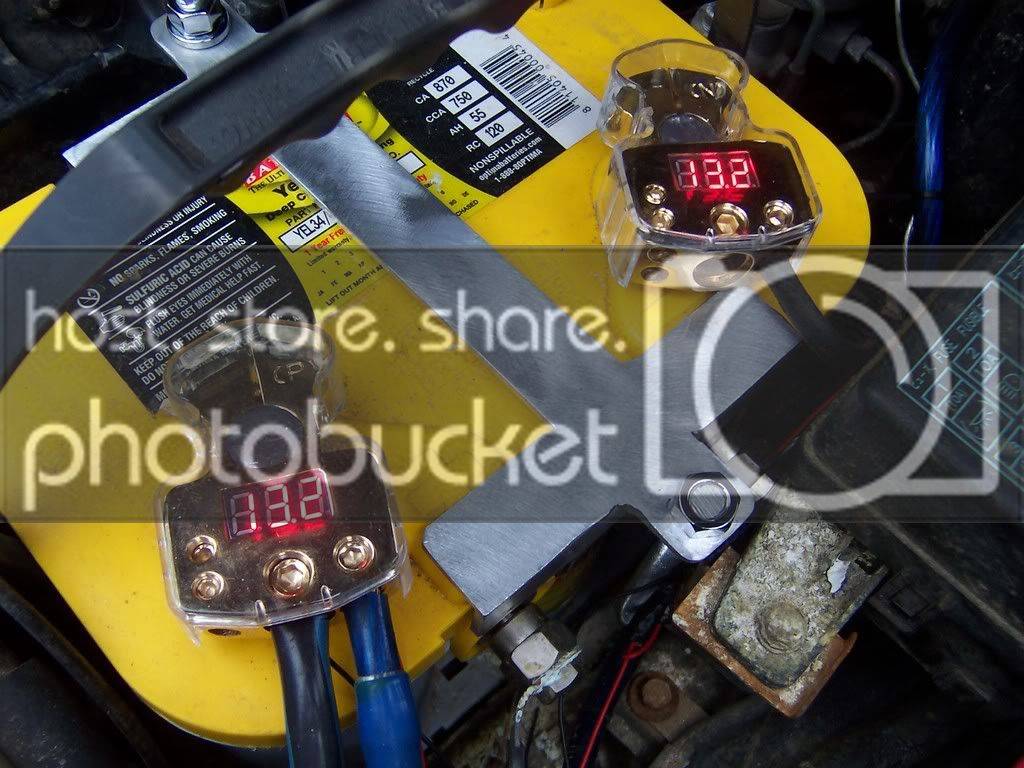

Stock battery tie down wouldnt fit over the bulky *** optima, so i had to do something to hold it in place... 1" angle, 1" flat, allthread and some chrome fasteners... along with a tig welder of course..
uhh...shit man I'd be worried having that much conductive metal right next to terminals...at least put some electrical tape over the parts the extend make up the sides of the "H" if you know what I mean
idk thats just me...you never know
same thing i was thinking, just wasn't going to say it as nicely though
haha yea, its the first thing said on the other boards too, and i meant to put it in my original post. everything is very tight, hard to move by hand, i will be taking it out this week to fix it up a bit, and thats one thing i intend on tackling. but trust me, its been there for a few weeks and has held up fine. zero movement.
thanks for looking out though.
