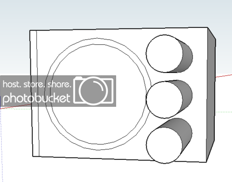

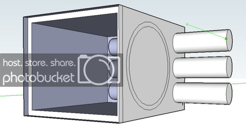

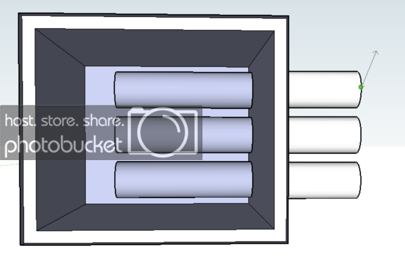

Ive been doing major research on the subject, even tho the info i found is scarce compared to some other stuff i have researched. Anyways so i think ive come up with a design that will work.
I will be using 1" MDF with outside dimensions of 25" width X 18" height X 21" Depth and should come to 3.56 cubic feet after displacement. The Ports will be 3 4" aeros tuned to 32 hz and will be ~27" long each. 15" of the aero will be inside of the box and the rest will be outside of the box
Will this work? I will also be spending $121 bucks for parts at partsexpresss for the aeros alone plus the wood, nails, glue, and chalking to seal the corners up. It will be one expensive box...
Also forgot to mention that the port area, if im doing it right, should be 37.68. That is oppose to a single 6" which should be 28.26. So im hoping this will be enough port area to not have any type of noise. BTW this is meant to SQL oriented.

go three in a bigger box. I"m using 3 4" tuned to mid thirties in 5ish cubes for my 15. couldn't be happier
I would but im concerned with sq going down but even more importantly im afraid of power handling going down. Ive read these subs cant handle much more than 1200 as it is.

If my design that i posted up top works my only concern would be how to physically keep the ports stable as they are pretty long.

Yhea dude it does **** but if it does work then money well spent. Im sure ill have a smile on my face.
Well that's my concern is the external ports. I've never been a big fan of that look. I've love aeros and have used them many times. If you could alter the size, you may be able to work out that issue. Otherwise your on the right track.
