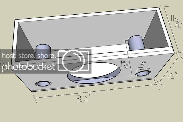

Heres the design, Unrated made it for me! The only thing im concerned with is the aeroport issue. The box i have now was made quick to get my sub going. Its tuned somewhere around 32hz, and the lows sound like poop. the mid highs sound great, but i love my lows. the aeroports in the design are 9 13/16'' long, 3'' wide, and theres 2 of them making a tuning of 34hz, i want to lower that, but from what i understand i have to make both of them longer. can you guys give suggestions? its for a 12'' fi bl on about 1000wrms.
and all the chicken scratch is me, ms paint sucks dick.

save the time and effort and just do an slot port your going to catch hell trying to sand pvc by hand. if u can just use 1 big *** pvc like an 8-12" pvc

how big is the box?
it was, i built the box originally for 2 12'' cvx's. 4.5 tuned to 32.
built the box, didnt fit the trunk, traded the subs, bought the bl.
I figured i could use half of the 4.5 and use the 2.25 or so left. cut it in half, and bam.
but in the process of building, i ****ed up the port and instead of putting it behind the baffle, i put it on the outside next to it. ill get a pic to show you.
