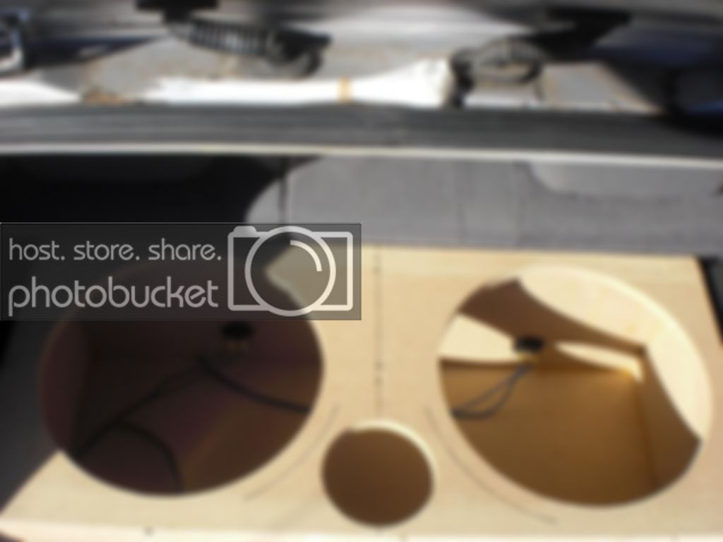

I built a box for a buddy, total box volume before displacement is 3.34cu.ft
Its for 2 low end Soundstream 15s, like 400w rms each.
I want to do aero ports, but not sure what size and how deep.
I was thinking maybe 2 2in aeros at like 12in deep each or 1 big one?
Any ideas?
Any ideas?
i'd do either dual 3" or single 6"
It was the biggest we could fit.
honestly, you should go to 1 15" sub and use a single 4" aero port. you'll probably have a better result b/c that'll be a more optimal enclosure for the sub than a box that is too small. or make it a sealed enclosure and use some polyfill.
the older model SS subs were low power sq designs the box is plenty big for them you only need 8-10 sq in of port as well for them they dont move enough to cause bad port velocity. a single 4" per chamber is plenty.

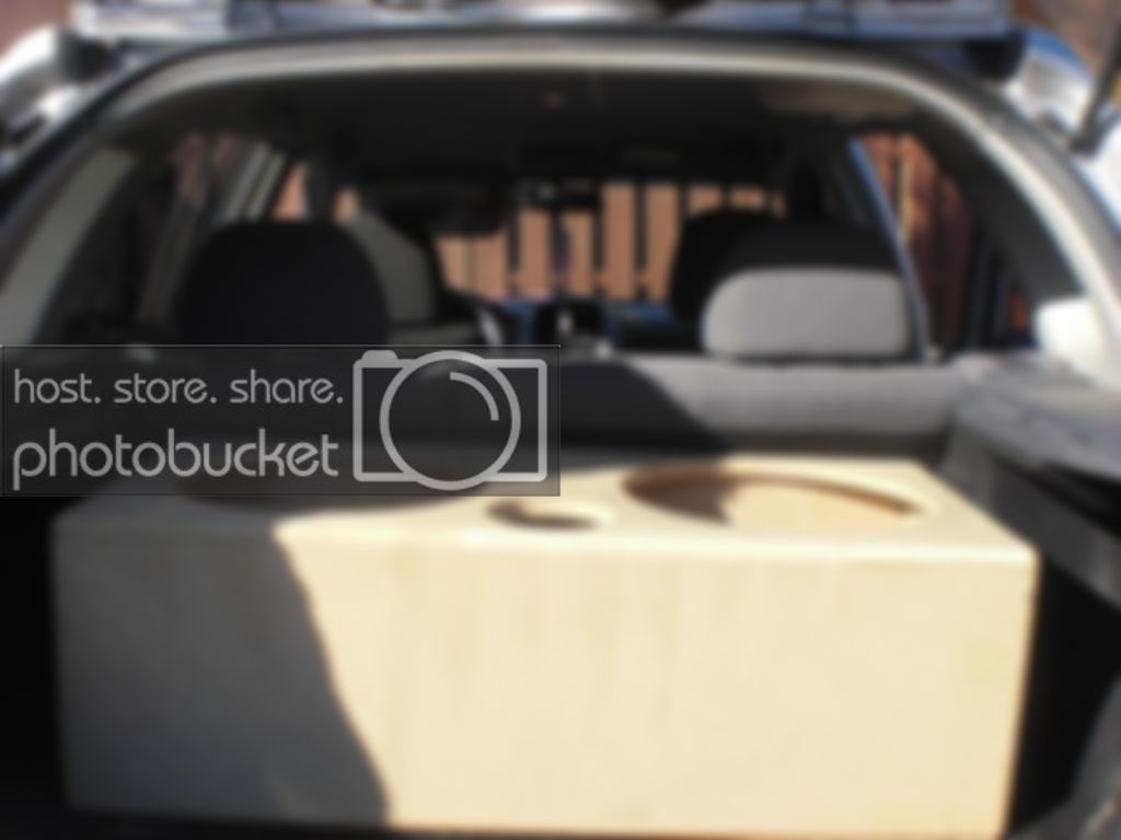

Built it today, opted for a 3in aero @ ~5in deep. Comes out to 30hz tuning if I am correct.
If i sounds bad Ill add another 3in, but I think this will be fine
Any opinions?
Needs more box.. and needs more port area..
You will need to increase the length on each 3 inch to maintain tuning..
IMHO at LEAST a 4 inch aero.... just my opinion.
