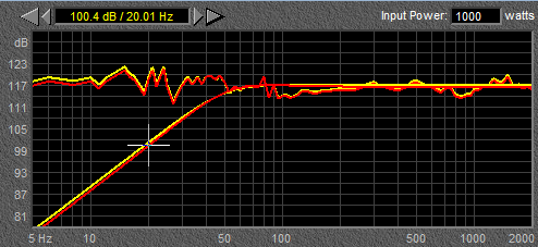

id get one of these...
heres the 12" IDMax and 12" W7, both in 1 cu.ft. off 1,000 watts
the yellows the W7
