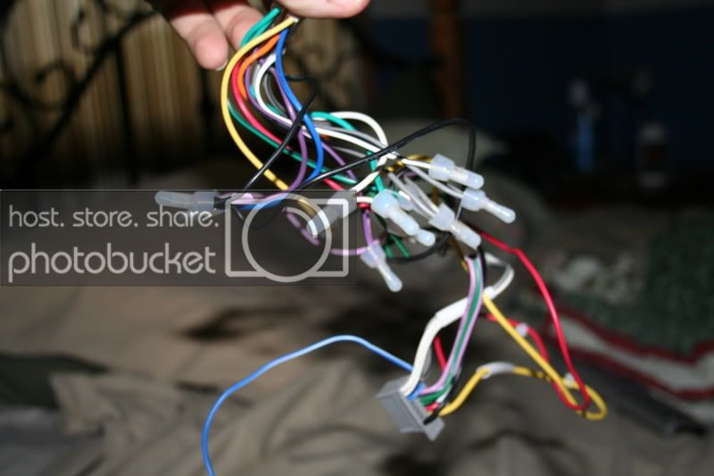

Okay now we are getting somewhere. I just uncrimped them by mistake so I could crimp the antenna wire and the sub wire. I didnt realize I uncrimped the Violet one it looked pink and the Schematic I saw said pink was the GM stock antenna wire color stupid auto pilot brain of mine.

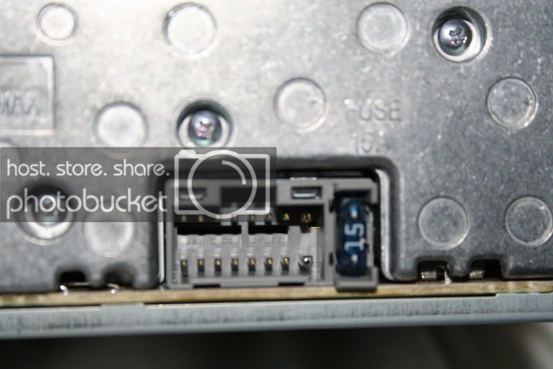

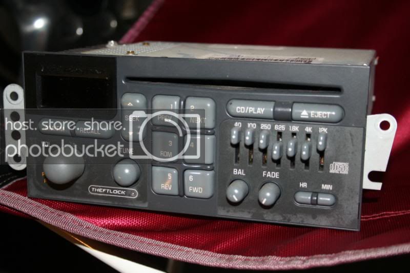

Okay got the HU out there is not a way to tell by looking at the outside if the outputs on the HU are shot?
incase these would somehow help lol
