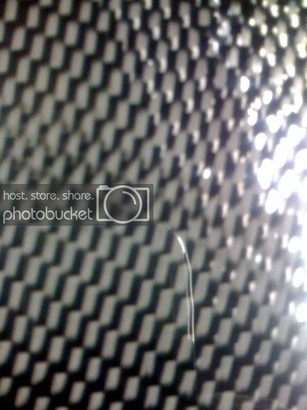

Some carbon fiber how to's I have learned.
A scale is a must. Once you have cut your cloth to fit weigh it and use grams much easier to convert than ounces. The reason for weighing is to get the proper amount of epoxy to use. I used 50% resin to cloth.
Putting epoxy resin is much slower than fiberglass resin, you can't mix it hotter to speed up cure and outside temp can increase the cure time. Count on a minimum of 12 hours per coat.
Before laying the cloth apply your resin on the piece using a paintbrush. Next lay the cloth and I used a 4" foam roller to press the cloth down. The roller will also spread the carbon fibers out to give better coverage.
In about 2 hours you can put 2nd coat of resin down then let sit overnight for all other coats. My 1st coat(wet out coat) was 210 grams next I reduced to 150 grams. All final coats will be 120 grams and these are to give the usual 3d look.
My weight measurements are in divisions of 3 because I am using is a 2 to 1 resin which makes it easier to do the math.
Mistakes I made the 1st time. Epoxy does not stick to masking tape so I decided to use it to contain the resin within the box, the problem it causes is that it makes ridges at the tape that needs to be sanded down then you have to polish the crap out of it to put the next layer.
I used 210 grams of resin on 2nd coat way to much since I had already wet out the fiber.

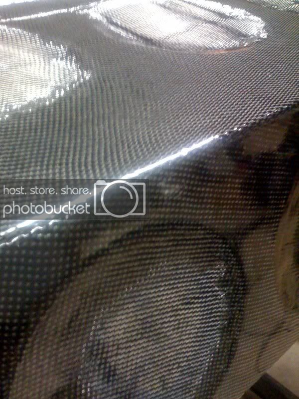

Sometime this week I will be vacuum bagging the door panels. I will have pictures for this since it is more complicated.
More pics

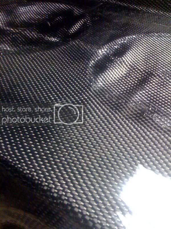

1st coat of resin using shop light to speed up cure for 2nd coat

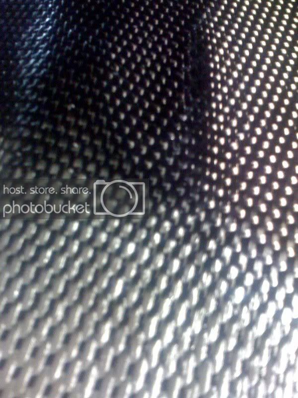

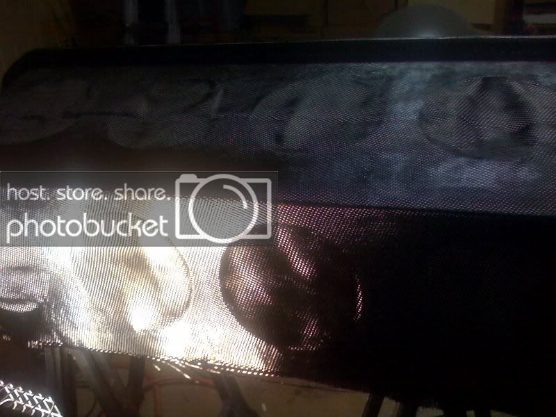

Without a layer of resin carbon fiber looks more like snake skin

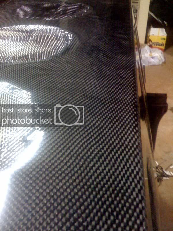

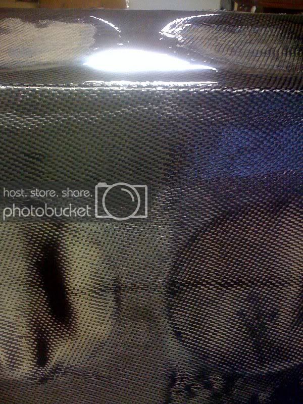

Now it is looking more like carbon fiber is supposed too.
Here you can see the difference in the same pic
