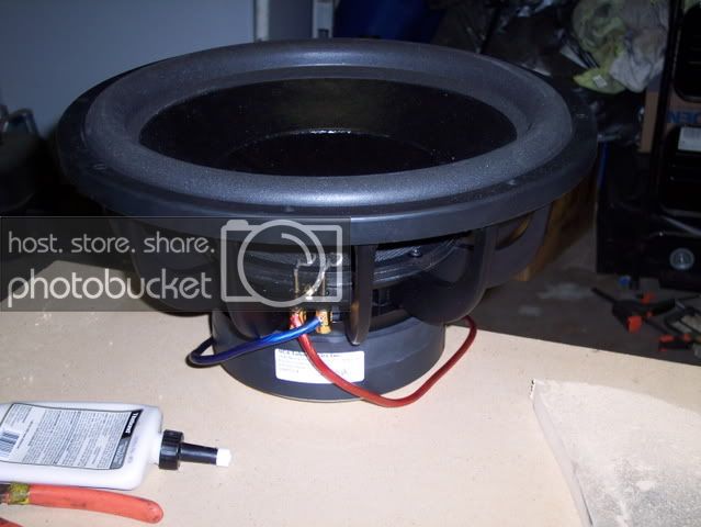

15" SI prototype Mag
AQ1200D
3.5ft^3 @ 34hz
PG RSD6.5
MA HK398 (150x2 @4ohm)

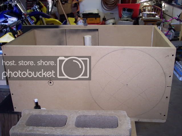

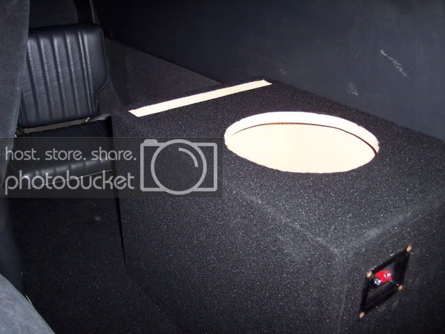

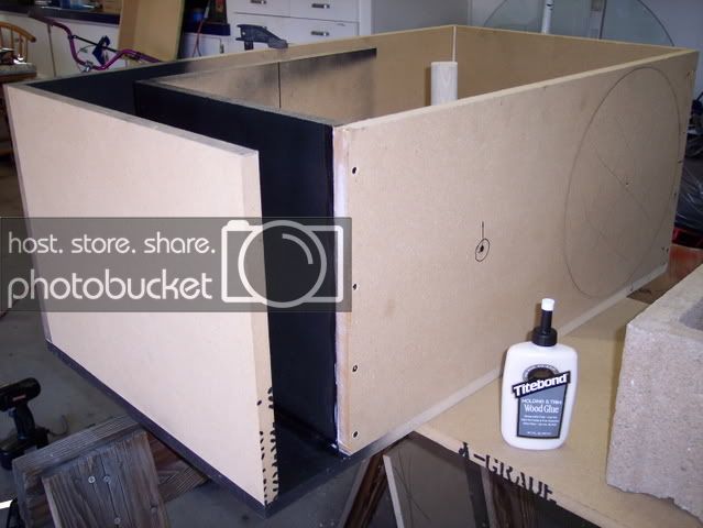

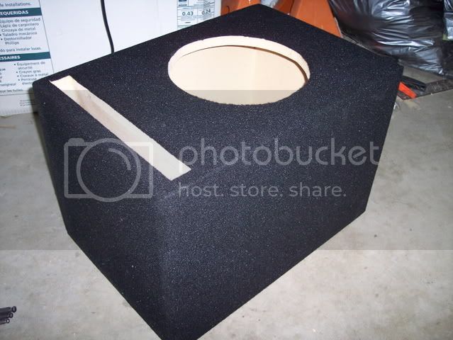

Here's a couple pics of the first box I built, which was for my old 10". 1.3ft^3 @ 36hz
The sub:

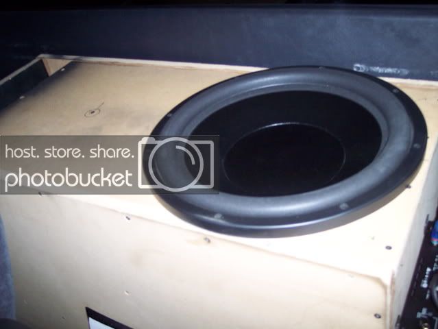

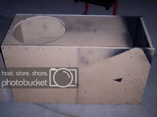

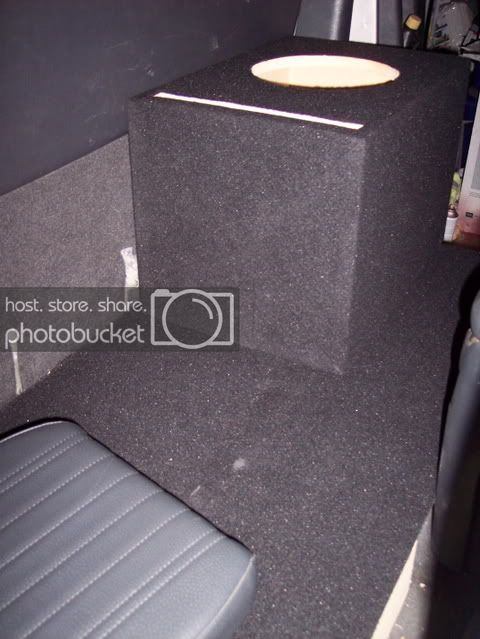

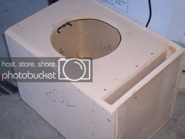

This is my current box....
Some of the cuts were a little bit off because I rushed things a little too much, so I had to go overboard on the screws haha
It still needs to be sanded/carpeted...

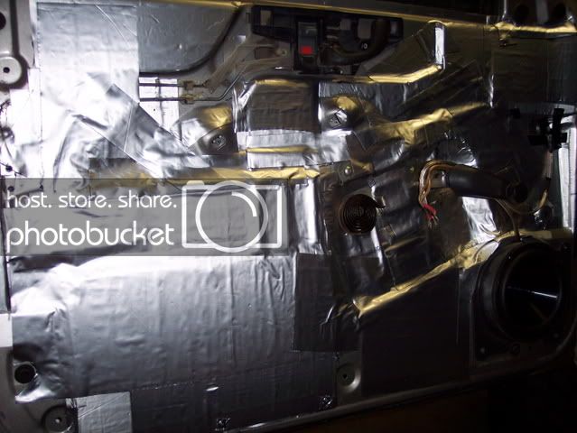

My driver side door fully deadened and sealed with 3-4 layers of EDead
Im gonna finish the passenger side tonight, I have to put a couple more layers on. Then tomorrow build some mdf baffles.

looks good. you can play around a little with firing direction also. try it forward. i've found that downfiring sounds best to me, in my s10. forward seemed to work pretty well too. up didn't seem as loud to me. //content.invisioncic.com/y282845/emoticons/smile.gif.1ebc41e1811405b213edfc4622c41e27.gif

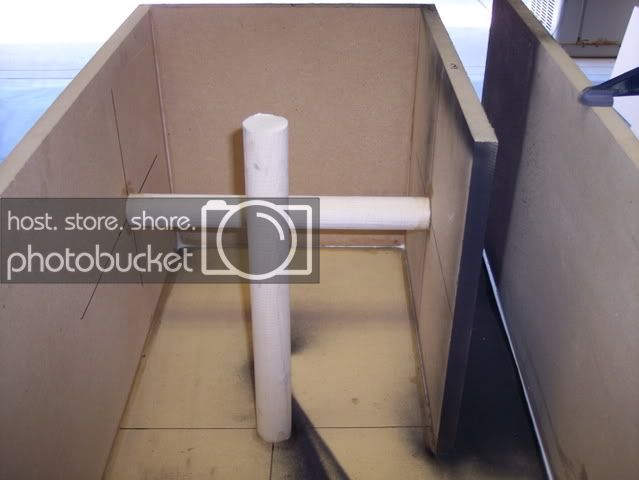

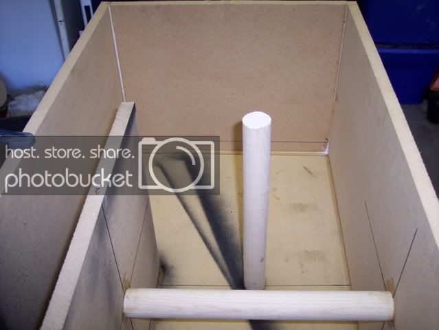

Yeah the dowels are kinda overkill, but I figure it cant hurt any...haha
oh and I played around with the direction with my ten, I liked up firing best so far, although I've never tried down firing... I might do that with the sealed box I'm gonna build.
