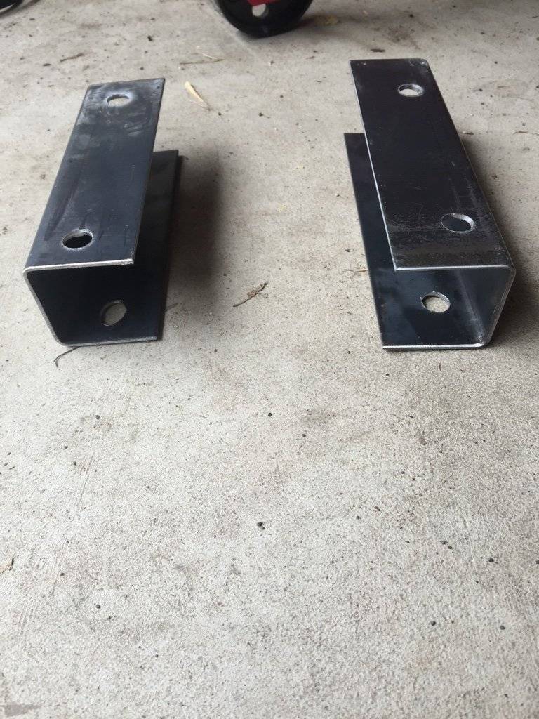

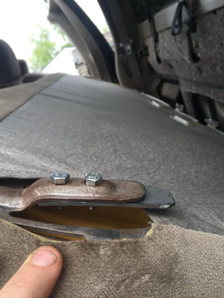

So I've got my 2" seat lift being cut to size and holes drilled today... It's 2"x2"x2" u channel and I've got a 48" chunk... It requires 15" per set so I'm thinking if all measures up properly I might have my guy cut and drill 2 more lifts out of if and put them up for sale on here

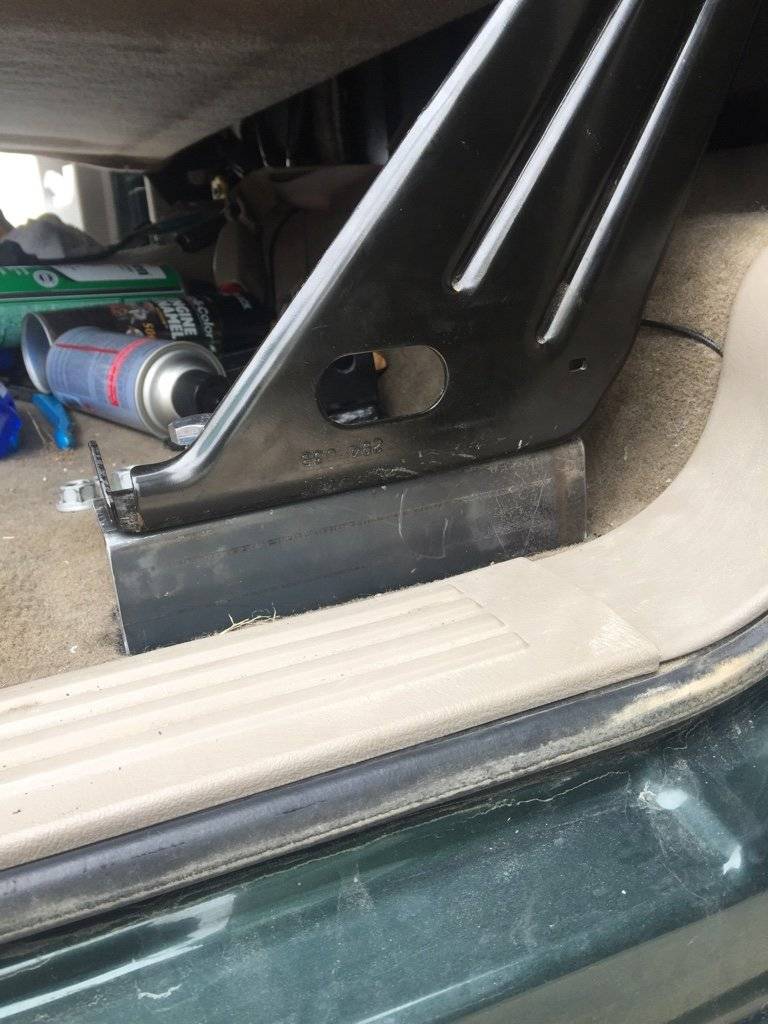

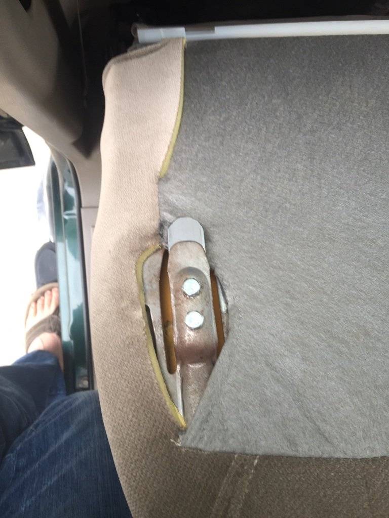

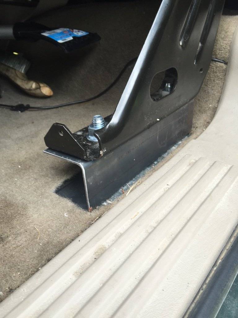

Well here's some photos gonna tweak the hole mounts for the next two I have done up so it will line up perfect also I'm looking at steel stock to extend the hooks so they stay hooked solid... They just barely catch now so when you go to fold the seat up they will fall out but I think I got that figured out
And side by side
Update...

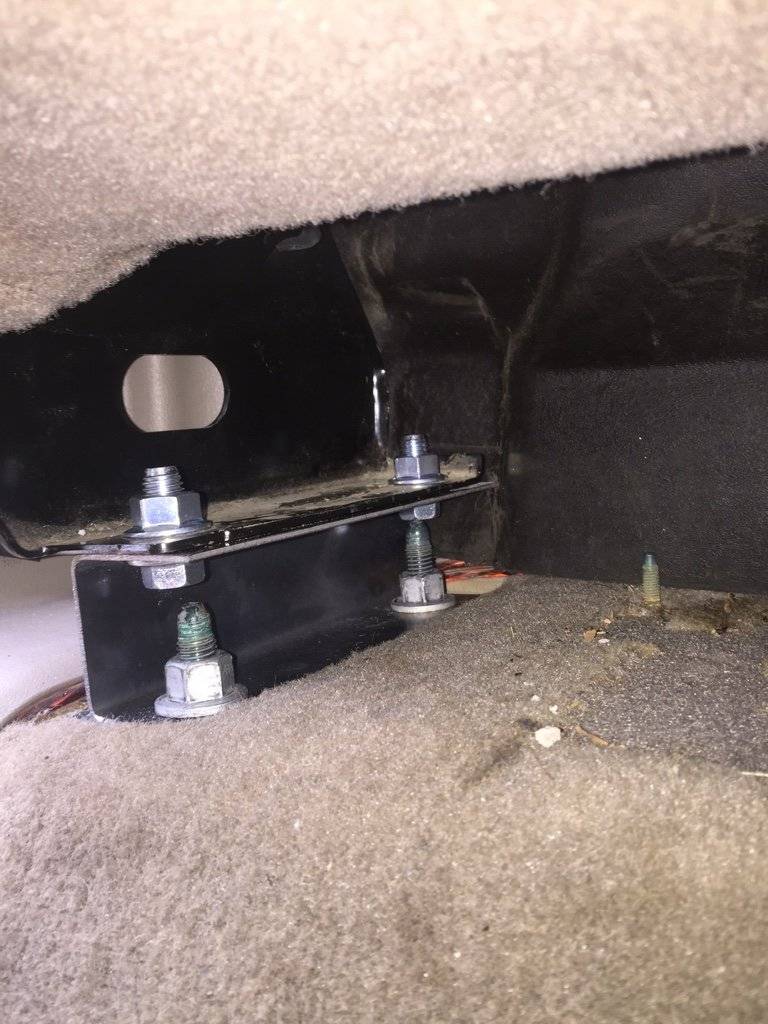

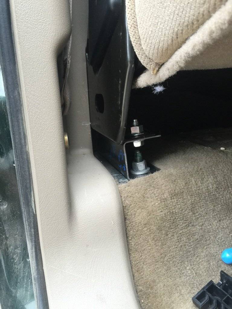

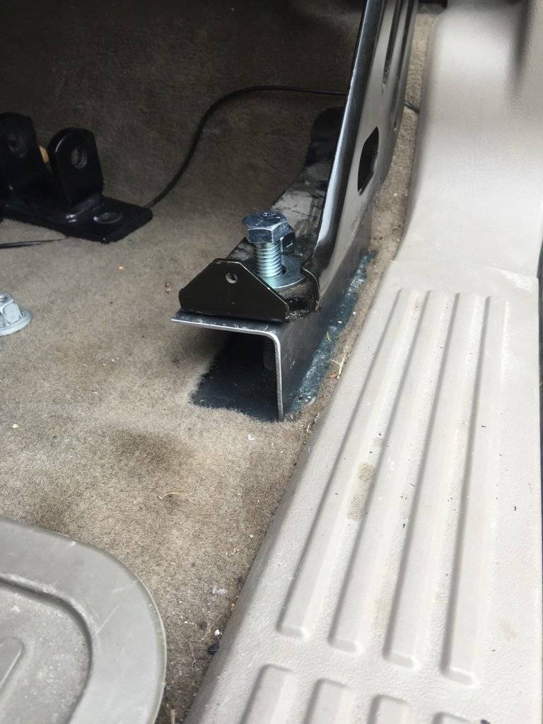

All bolted in and hook extensions were necessary to latch the back rest... So I fab'd some up... At current hook ext. length it still allows you to fold your backrest down so if you have your amps mounted behind the back seat it will be easy to access your amps... Anyways here's the mounted pictures
Now this is put together with exact metric bolt and nut as stock.. So 18mm wrench and socket will get the job done... You will need to have a 18mm open face wrench to install
Will be tack welding bolts into place on seat mounts and the nutz onto the hook extensions for ease of installation... Because believe me the hook ext. were a mother to install
Cost of hardware was $20
Then add another $20 for the hook ext.
And $50 for the seat lift brackets...
So total cost if interested would be $90 plus shipping from 56479

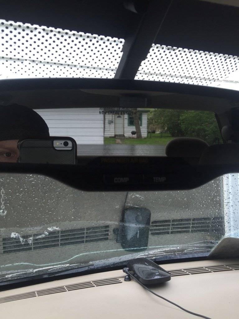

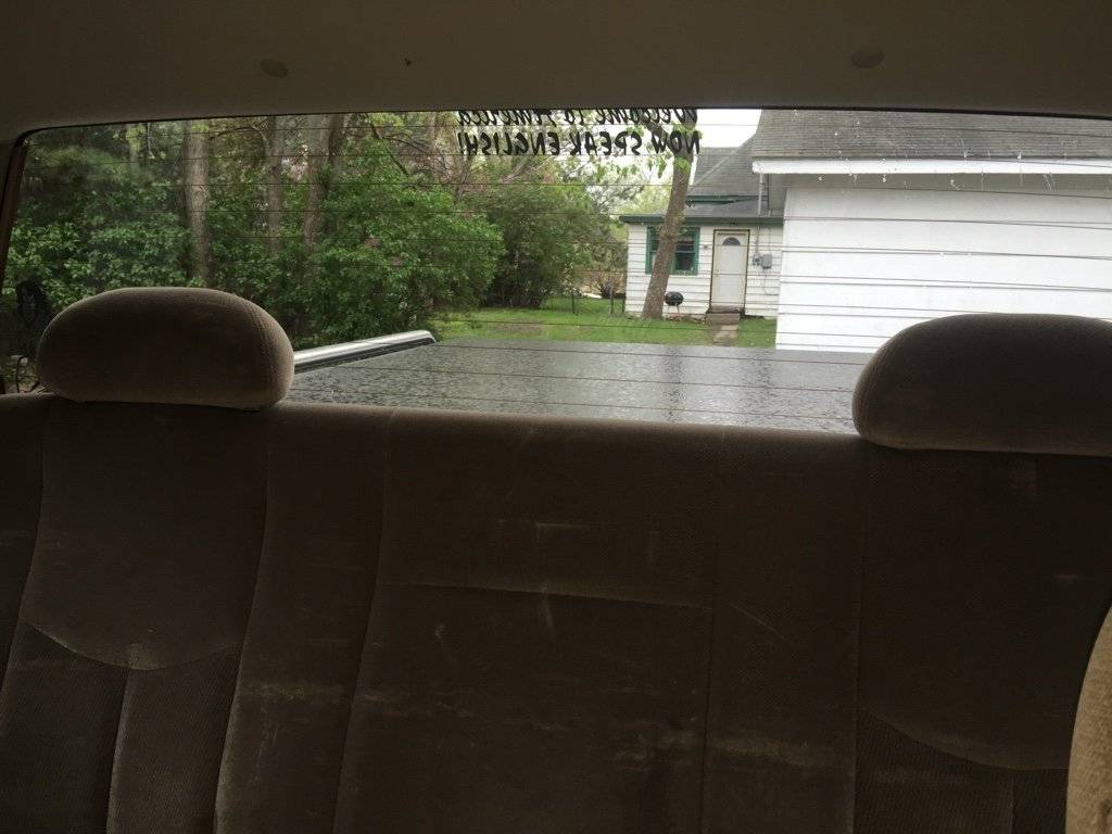

Looks great, paint those pieces with some semigloss black and it'll look great. It's been so long since i had the bottom of my back seat in my truck i forgot what the mounts look like lol. did you lose any view out your back window since you had to raise the back of the seat as well?
No visibility lost could actually go up another 2-3 inches but your passengers would have to be short
Head room for a 6"3 me in the back comfortable

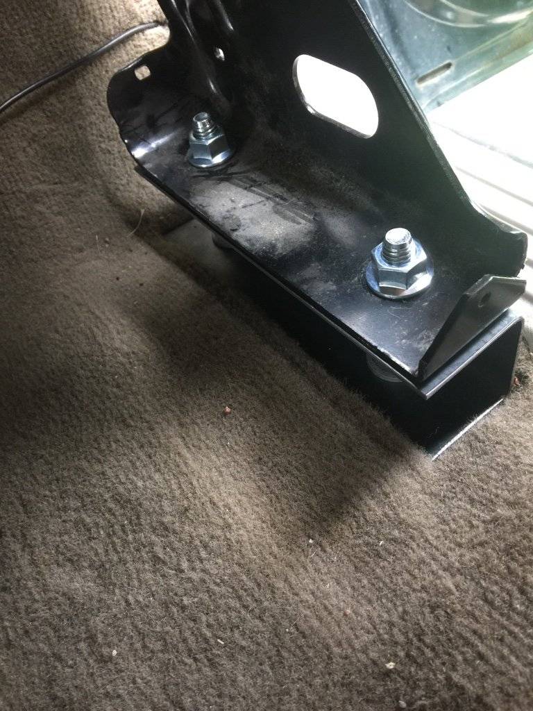

Already got the paint just need to do my welding before I spray and make more hook extensions before I permanently install
