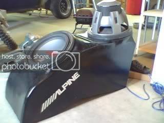

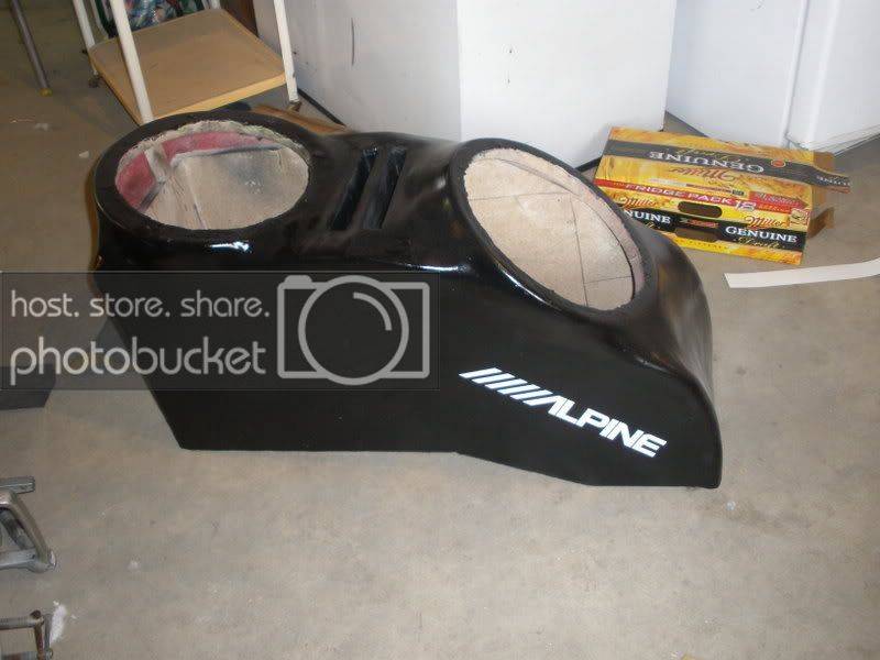

Hey CA, I am just finishing up a few projects on my 98 dodge ram 1500. I am doing some fiberglassing for it along with a lift kit, rims, and tires.
I first built a box to go in the back seat of the truck as a console that holds 2 Alpine Type R 12's
Each chamber sits at 1.3cu and is tuned to 34Hz, Sounds pretty **** good.

Lookin good, nice glass work.
One question though, why did you opt for such a small chamber for each sub? Space limitations? I would have put them in about another cube bigger a piece......atleast.
yes, space limitations....
